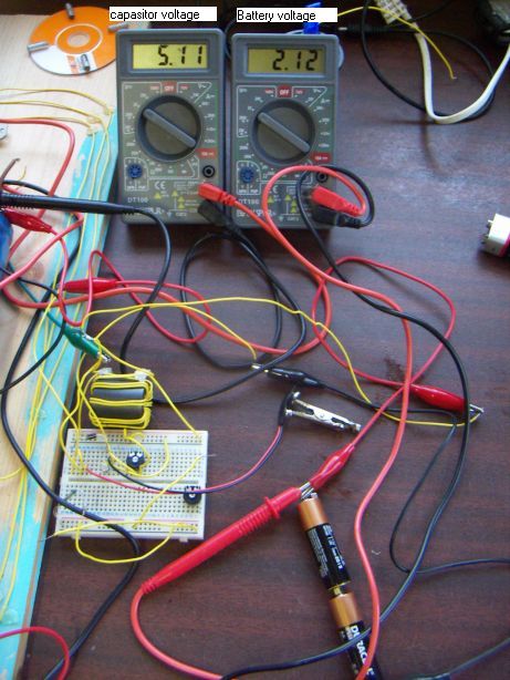

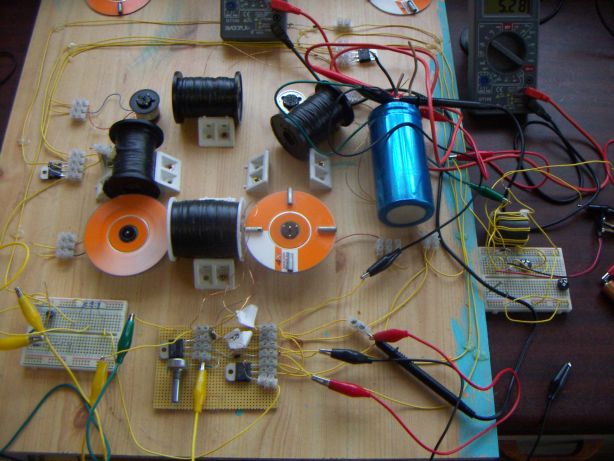

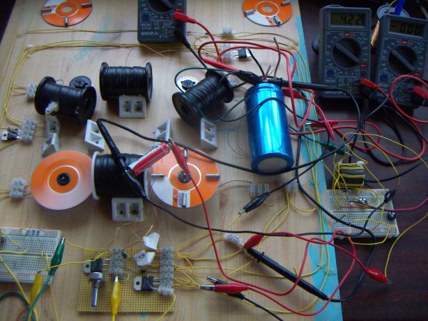

    Hi.I have been playing around with the joule thief circuit and i am amazed at what i can run with it.Reed switch motors, Dc motors all work great so i thought i would try it with my Bedini Motor.I used my 4 rotor bedini as the test bed as if i got it going i wanted to see if it could run a slave coil as well anyway i am pleased to report that it can.
    It spins really fast on 1.5v and can light the neon.
    It spins even faster with the slave coil connected as both coils are pulsing the one rotor using 2.4volts.I will buy some new batteries and see if the slave will run on 1.5v.It will also spin two rotors off the one coil.
    I have attached some pictures and may make a vid.

    jonny are you saying your running all 4 coils from one as a multi coil? Whooly crap man thats impressive. At that watts in thats prob the best solar Bedini contender i have seen man well done. Keep going.
      Hi ashtweth.I am using a combination off two coils.The master and one slave.The other two coils are not connected and have been moved away so there cores don't add drag.I have used my four rotor bedini as it is perfect for testing this out as i don't know what this circuits limits are and i can add slaves and rotors as i improove it starting with some new batteries tomorrow.

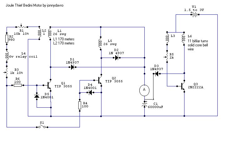

          Hi.Here is my circuit diagram.

            @Jonny
            I noticed that you were pulling you negative charging off joulethief driver from the negative terminal of the source battery rather than straight from the coil. That would seem to drop the source battery quicker. Can you clarify as to why you chose to do it this way?

              You are using a car audio capacitor as well in your setup? I have been playing with supercaps with a bedni. Looks very kool. Thanks for sharing, please let us know how your load tests go with the devices you charge up with these.

                @redeagle.Not to sure what your refering to.The joule thief part is pretty standard apart from different type off diode and a cap.
                @theremart.The cap is a 60000uf 15v electrolitic.The joule thief will charge it up to 15 volts in a couple off minutes if a load is not paced on the cap it would empty its contents on my ceiling.I got it from a car boot sale for 50p.Bargain.
                Regards jonnydavro
                  Hows about you loop L2,L3 and L6 too before the Transistor with a Diode?
