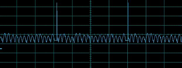

          Elias, I tested the selfrunner setup and it did produce pulses of 2000V. But the recovery coil must be pulsed to get this result and also in the right timing. If I did not pulse-discharge the coil, it produced only about 30V, but when I pulsed at the right time on each revolution with a relay to the primary battery, I could get those high voltages. Also, if I loaded the recovery coil just with a light bulb, it created a serious drag on the wheel, but when pulsing the coil, it did not create any drag at all I will draw a schematic of my setup later
          • #20
            Here is the circuit I used for the self runner setup
            Ihe timing must be exact to get those high voltage spikes. I used a tiny magnet on the rotor, that triggered a reedswitch allowing the relay to pulse the energy from the recovery coil to the primary battery. In the same time the rest of the circuit is disconnected form the primary battery. The recovery coil has to have at least 20Ohms resistance, the higher the better, because when the speed rises at startup, you can see on the meter, that the voltage across the recovery coil increases. But the 2000V spikes start to appear only when about 30-35V are reached. So if your recovery coil can not generate at least 30 volts conventionally, it will be hard for you to get those high voltage spikes. If so, just add some more turns of wire on your coil. The magnets are in NSNS configuration. You must place the neo magnet so that it triggers the relay just after the N magnet has passed by the primary power coil and just before the next N magnet. That way you will get the high voltage.

                      I finally got some time to experiment with the self-runner coils. As I experimented thoroughly I conclude that the high voltage
                      spikes appear after the swicth opens like the collapsing magnetic fields when pulsing the coils, but this time the coil is charged by the moving magnet instead of the battery. When the battery is pulsed, the spike is release afterwards, when the relay opens. So I think that as we pulse the battery these spikes get stored in the capacitance of the coils and build up there for better pulsing each time, but not so sure. Maybe we can capture these spikes and charge another battery with them. The attached scope shot clearly shows the fact that the spike is released when the relay is opened.
