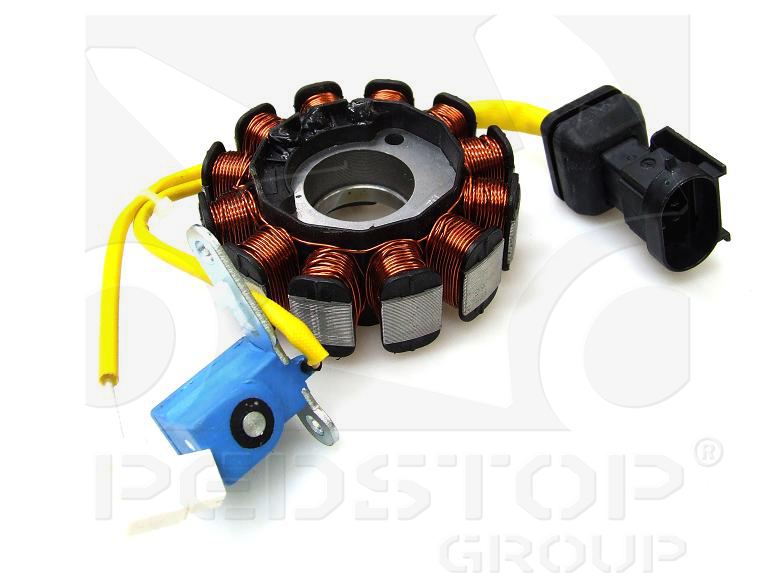

          The stator from a motorcycle alternator may do the job.
