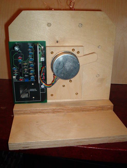

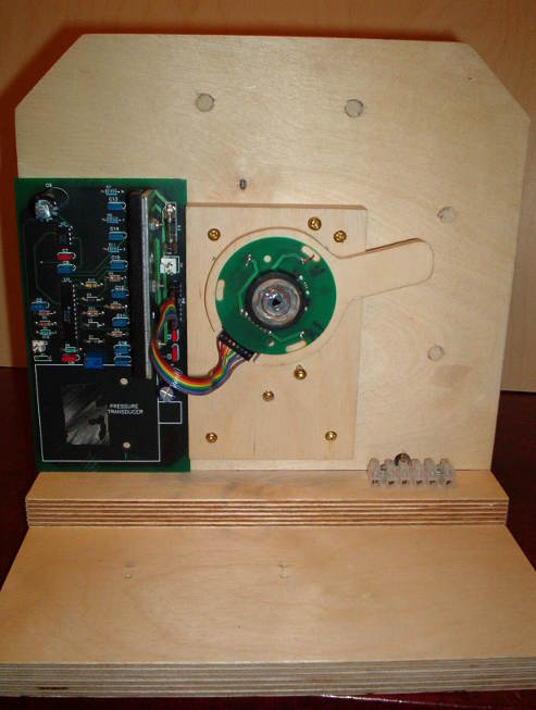

      The small magnetic rotor was drilled to 1/2" from 1/4" and installed. The wiring is done from the coils to terminal block, color coded for polarity of the drive coils. Now it only need to be connected from the terminal block to the Hall Effect sensor module. We will use highly flexible wires for that part, unfortunately the wire are at my friend's place.

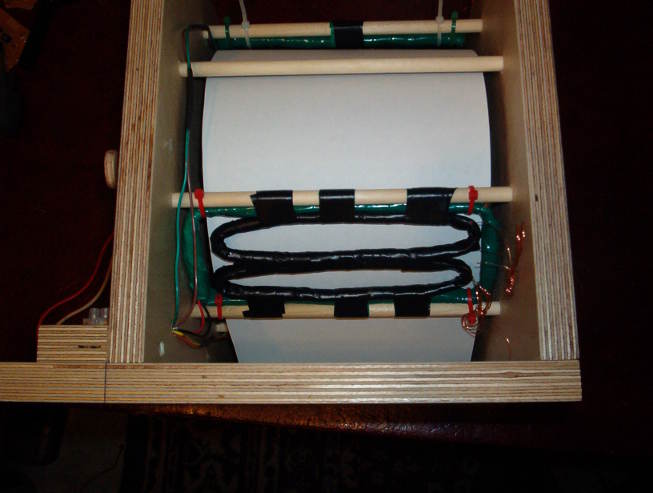

      Meanwhile I have to make three different output coil jigs and wind the coil(s) for each shape to fit inside the drive coils for further tests. One form is rectangular single coil, the other will be rectangular two coils and the third will be 2 right angle triangles. All coils will have the same length of magnet wire and won't be bifilar for the tests but will be in the final version. The highest output wins.
      We will also monitor the drag on the motor from those different shapes by measuring the input pulse size on the scope and also with an ammeter at the input. That will be my friend's work as I have to start building the second unit.
      Take care all,
      Michel
      P.S.: The motor end cap will fit nicely over the Hall Effect sensor circuit.

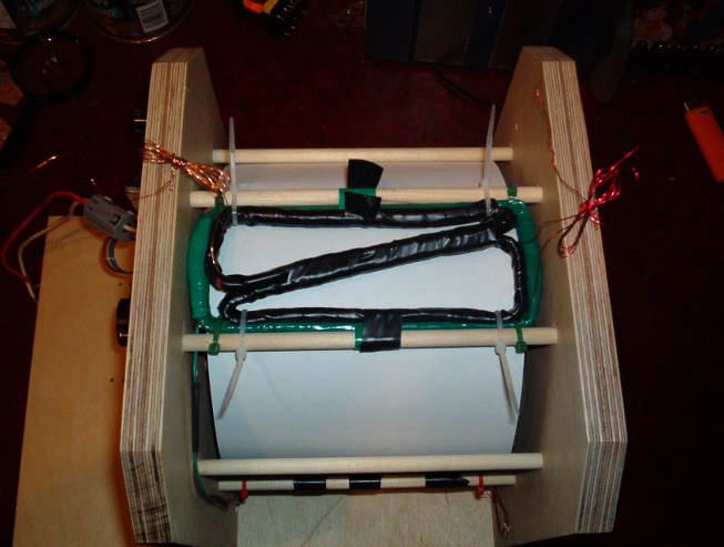

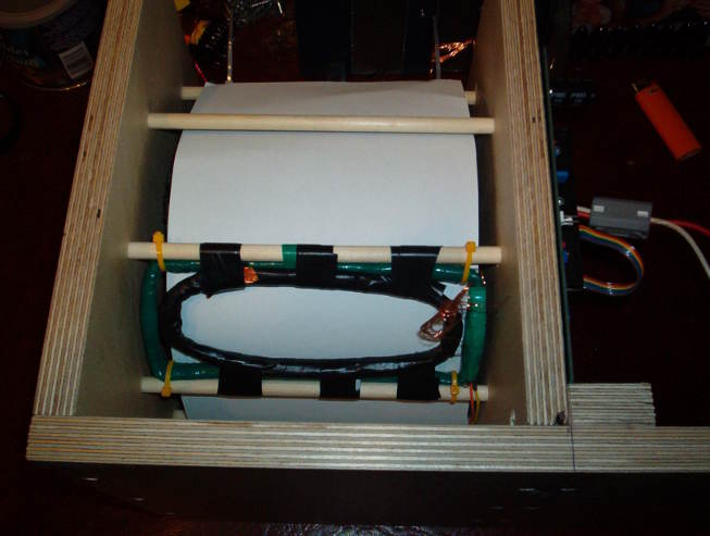

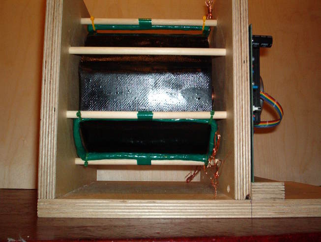

        Last update for a while.
        Hi everyone,
        The motor/generator is finally done and away at my friend's place for testing.
        As he is still amongst those who have to work, it may take a few weeks before he is done. He also wants to apply a few of his electronic tricks and see just how much he can push the actual output.
        So here are the last pictures showing some of the output coils he will be testing. I placed a white sheet of paper on the rotor for the pictures.
        Take care all,
        Michel

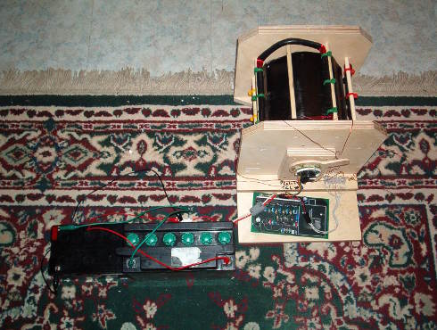

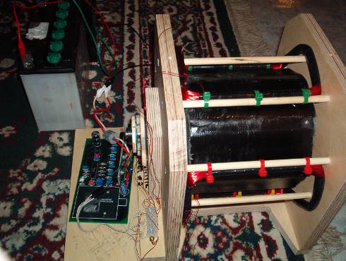

          Update on the built.
          Hi everyone,

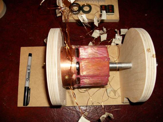

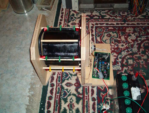

          My friend brought back the motor/generator after he did a few tests (he is very busy at the moment) and I needed to redo the drive coils as they were the wrong size to get this thing running efficiently and with more torque. It also needed a little re balancing since it was vibrating at 2,100 rpm.
          A few pictures of the motor with the new drive coils and cutouts in the bottom plate for a better access to the coils. The initial tests with the new drive coils gave 1,878 rpm and it may still need a few tweaks but after rebalanced, the motor purrs along at 1,850 rpm. The electronic module is feed with 24 Volts. I did not check the current used as my friend will do that with his scope.
          So the motor will go back for a few more tests before I make and install the output coils but it works great so far.
          Take care,
          Michel
          P.S.: The timing system works beautifully and it's quite usefull to tweak the firing of the coils.

            • #21
              Drive coils.
              Hi Mark,
              Yes the drive coils cover nearly two magnets but not totaly. When my friend tested the first drive coils covering one magnet, he could not get the motor to run more than 800 rpm. He then proceeded to detach one side of a coil and slowly angle it up to 90 degree from normal and got the motor to rev faster. Then he did the same for the 3 coils and got 1,200 rpm. He brought back the motor and I wound one large coil covering about 2 1/2 magnet spacing and driving with that one coil while bending it to cover less and less, we got 1,500 rpm from that one large coil. That gave us the exact size for the final and actual coils. They seem to work in a push-pull way. I have a small jar with iron shaving and when placed near the spinning magnets (NSNSNSNS configuration) the shaving rotates inside like flipping over themselves. Maybe other Bedini window motor replicators can do the same and see if they get the same results.
              Last night after a slight repositioning of the actual large coils, the motor revved to 2,163 rpm. The motor has now a lot more torque and a high spin. My friend will retest it for efficiency and then I will make and install the final output coils. They will be all connect in series to get a high potential/low current and I will then make a bifilar toroid transformer based on Tesla electric distribution design to drop to the usable voltage. The current does slow down a generator, not the voltage and even if we get a lost, the penalty will be minimal compared to normal setup.
              Hope this answer your question, take care,
              Michel

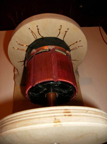

                  • #24

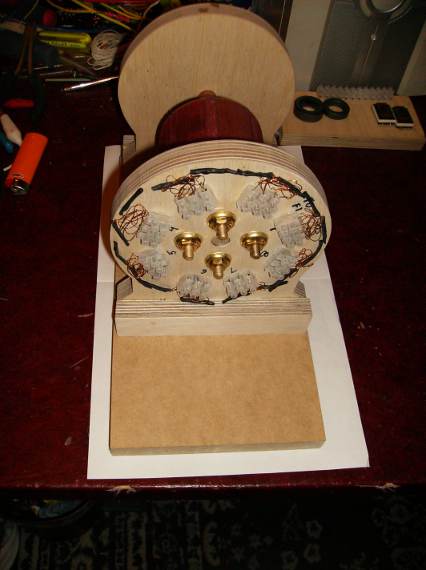

                    Motor/Generator V3.0
                    Hi all,
                    Time for a little update on the Motor/Generator V3.0.
                    I have a few snapshots of where I am at now.
                    The inner rotor is 2.75" with 4 2"X1"X.5" Grade 8 ceramic magnets and the stator (3" without coils) inner dimension is ~2.9375" with 8 coils(160 turns on 2 rows) of AWG28 magnet wire set in bifilar.
                    The vibrator generator works but the magnetic suspension does not allow a long enough travel to be efficient. I will use the coils and magnets in the windbelt version where I will use springs as binder. A magnetic suspension is good for support but it kills the oscillation dead when the vibrations pass a certain amplitude.
                    The Kohler Magnetstromapparat is still on the back burner. I bought a magnetizer on Ebay to set my magnets and I have designed the coils that will wrap them. All that is left to do is to wind the coils over the steel magnets and start testing.
                    I am also testing my Orbo test setup with different toroids and windings. No freebies yet...
                    That's all for now, take care,
                    Michel

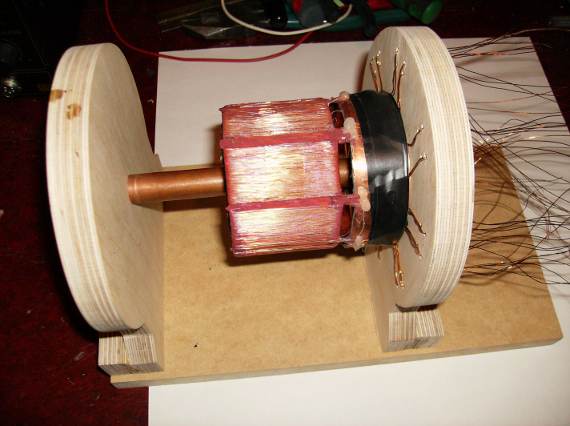

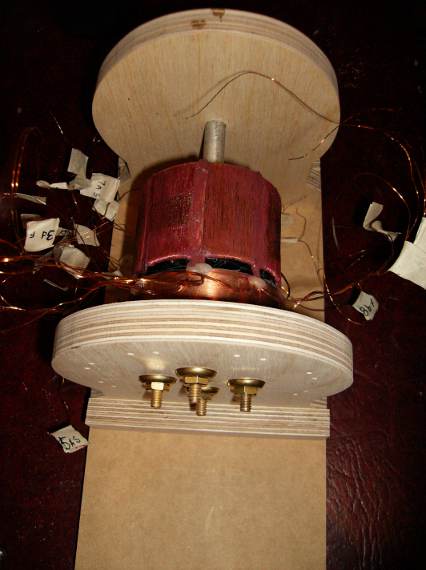

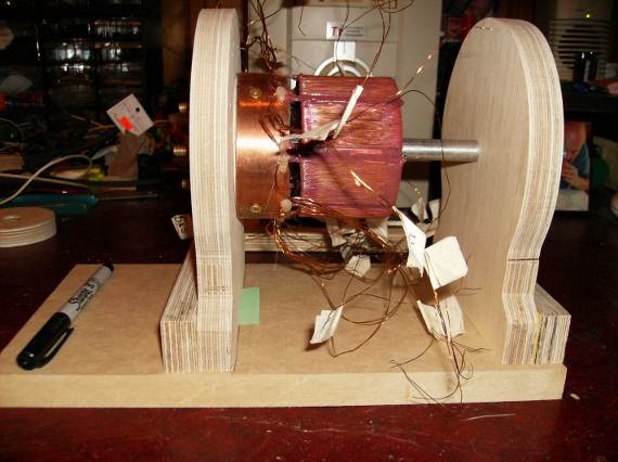

                          Update.
                          Hi all,
                          Just a small update with a few pictures.

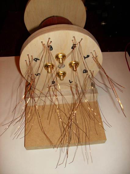

                          The motor is ready and going to my friend's lab for tests. If all goes well, the second rotor will be added, the 2 rotors will be counter rotating.
                          The stator has 8 coils, each made of 2 bifilar coils for a total of 64 wire ends. I'll ask him to bring the motor V2.0 so I can fit the output coils all around.
                          Take care all,
                          Michel
                          • #28
                            Hi Michel
                            Your coils look great! I'm not really sure what your new setup is but it sure looks nice. Keep up the good work, I'm looking forward to updates.
                            Mark
