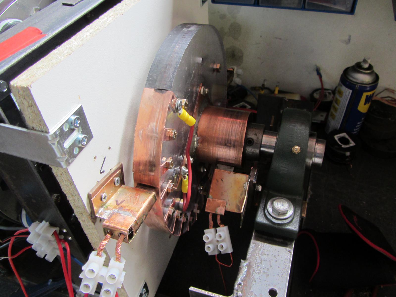

      I have modified the FEG as per recommendation of Mr Bedini in his booklet. I have found that this change has provided an new intellectual challenge. Clearly, to get this FEG operating requires some thought. It is relatively easy to synchronise the brushes with the switching of the capacitor charge/discharge and motor runtime. However, my coils are not providing sufficient "energy" to maintain the momentum of the flywheel. The situation is worse than when I at least had it running off the relays and a timing circuit. So either I need a counter to enable a sufficient charge time for the Cap, or I need to rewind my coils to provide a low impedance load - get more current through.

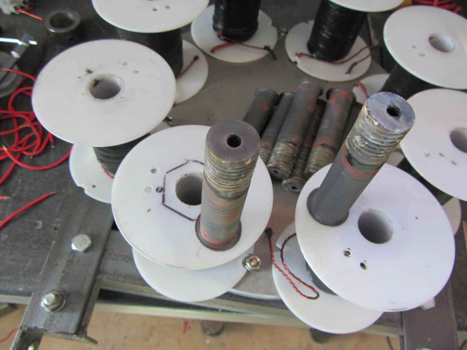

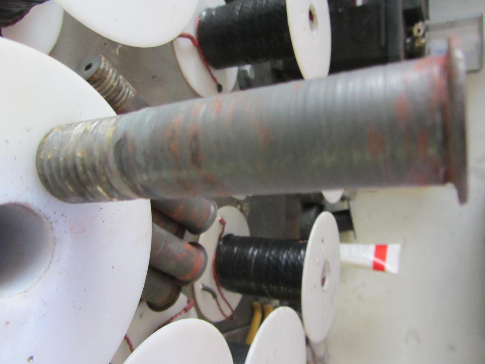

              my apologies for the delay in replyin. I have attached a couple of "development" photos. Mostly self explanatory. I have rewound the coils trifilar 20 guage so as ro capitalise on my tank storage and the opportunity to create a low impedance source. I got 8 x 20mm bolts from the wreckers and machined them down to 19.5mm diameter.
              I have a small old electric kiln that I got at an auction some few years ago for $50 - not working. Replaced the contactor and it buzzes along. I annealed the machined bolts at around 1000 degrees to get the "Black Iron". The white spots on the threaded parts of the bolts is from the galvanising. I have drilled and tapped the end of the bolt 6mm metric so as to securely fix to aluminium backplate

              • Dear Dwane,
                I don't follow what you are trying to do with the kiln. If you are trying to create black sand, it won't work.
                Are these bolts normal mild steel ones? If so, they are not as recommended by JB. If you ring up a supplier of goods for gas welding, maybe suppliers of bottled gas, they should be able to put you on to welding rods. The suggested types are R45 or R60. They are not steel but iron and handle magnetism quite differently. Then cut them to length and bundle them up to get your diameter. (I think it is recommended that they are varnished or painted in gloss paint to provide electrical insulation and thereby reduce eddy currents with their associated losses and heat problems.
                You may be able to find iron by another method but it is difficult. (Sometimes iron is used by architects for foundations because it is rust resistant). Much wrought iron is nothing of the sort; it is wrought steel and sold as wrought iron.
