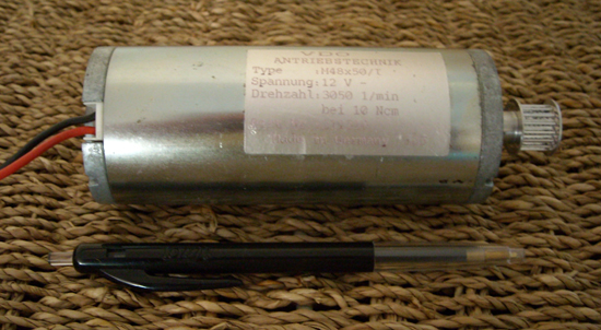

          Thanks again Steve, seems the right way, I suppose you are drilling a hole in the threaded rod to slide it in, and connect it to the axle? Do you use ball bearings on your axle? (Apologize for all my questions)
          Friday evening I did find the correct motor, see picture. It is made in Germany and the specifications are:
          VDO (brand name)
          Antriebstechnik (drive technique)
          Type: M48x50/T
          Spannung: 12 V -
          Drehzahl: 3050 1/min bei 10 Ncm (rpm)
          Best. Nr.: 211310 (order nr.)
