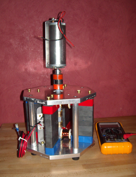

            • Thank you Don! for the compass info to find the right pole configuration. Right after that I build my Kromrey together. The only thing to be done is a support for my electromotor on the top plate.
              By turning the shaft by hand (and that is very slow, because there is a lot of resistance from the magnets) I did measure 2 Volts, an indication that everything is on the right spot. But I am a little anxious to start the motor on full 3000 rpm, which components will come flying out?
              • Looks very nice Paul.
                I can't wait to here of your results.
                Don
                • Nice.
                  Really nice build Paul!
                  She'll be right mate, let her rip!
