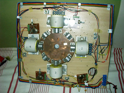

                          thanks for the reply tachyoncatcher.
                          Just to clarify before I buy some parts.....if I make a couple more 2 filar coils with awg 24 wire, and connect them as in this schem...
                          space them and the magnets properly....I'd hopefully have a multi coil ssg?
                          cheers,
                          Great thread.
                          • #43
                            You got it
                            Determine the best resistance value for your coil and battery you are charging, with your pot. Measure the resistance of that pot to determine the base resistance of the other coils. Add a 22 ohm resistor next to the pot. Also a grain of wheat bulb(12v 250-500ma). In serial, pot, 22 ohm resistor, grain of wheat bulb, then to other coil resistors as in the schem. Since your machine is horizontal, you can move the coil around for the best position, while running. Add one coil at a time.
                            I used a automotive, inductance timing light on the output of the primary coil to the charging battery. I can see the position of the magnets to the primary coil, while running, and just matched that up with the other coils to start my coil position tuning.
                            Good luck.
                            Randy
