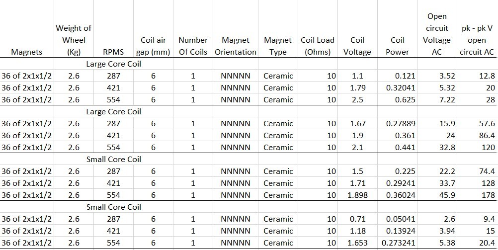

    I've done a side by side test of the 3/4" core versus a larger core.
    Same amount of copper, both 8 filar in series and parallel.
    The larger core will charge a capacitor faster even though it doesn't output a higher voltage due to less windings.
    Side by side comparisons show lower peaks but more power.
    Coils use the same length of wire.
    The higher voltages are series, the lower parallel.
    Large core is 714mm2
    Small core is 314mm2

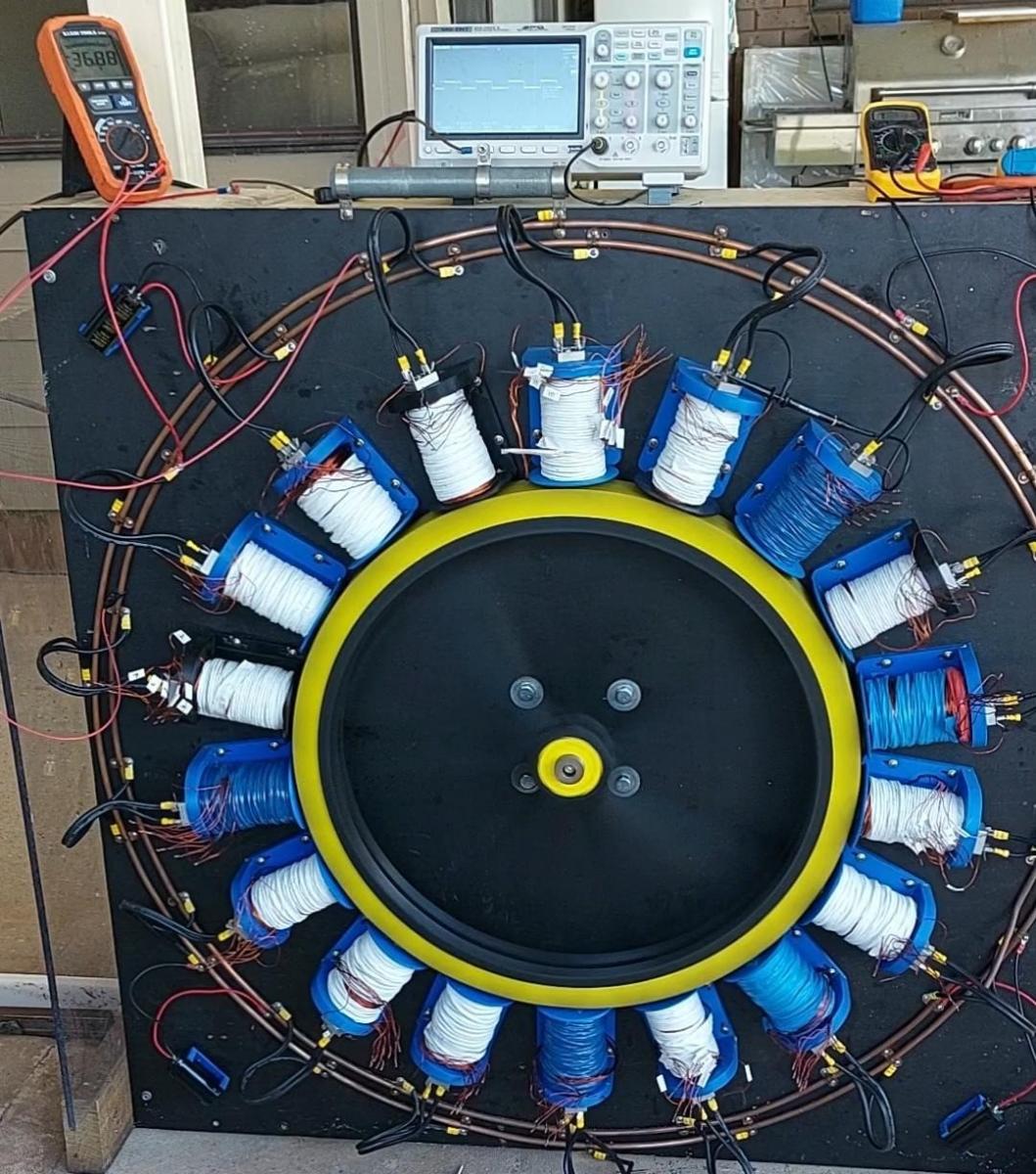

Name:	18 coiler.jpeg

                  Looks good! Any data, details?

                    You are better than I am. I have not worked this hard on free energy yet. It looks like an ssg on steroids. Nice going. It is also clear that these coils are exactly like the one you posted and now the data makes more sense. Thank you for responding
                    18 coils should put out a lot of power to a battery pack using a solar panel. I call these converters. I used a solid state SG then sent that power to a cap dump.
                      This setup is a 20 magnet rotor, 18 coils.
                      Wheel is 650mm diameter, 3D printed with interchangeable magnet wedges.
                      At 691 RPM'S a single coil is pushing out 180V pk-pk at 230hz with a 10mm air gap.
                      The 4 capacitors on the front board at 60,000uf at 80V and I have to limit it with the rheostat or I will exceed the voltage without discharging.
                      Standard Ohms law calculations tell me its putting out 16w of power, however the rheostat (rated 280w) is sitting at 90 degrees Celsius.
                      While using a resistive load energy recovery is at 76%
                      Data is very raw at the moment but shows promise.
                        Some more interesting data.
                        Finally my Capacitors (12 of 18 anyway) turned up.
                        So with 2/3rds of coils having Caps across the coil collecting the spike, output went up 815% while efficiency went up 13%.
                        The peak to peak voltage is the same equivalent without the capacitors.
                        While I haven't timed it yet the machine at 273 RPM's is charging the Cap bank faster and higher than at 691RPM's without capacitors even though pk to pk waves are 47V vs 100V.
                        Highly interesting is that even though the coil pk - pk wave is 47V (oscilloscope) its charging the capacitors way up past 80V before I had to shut it down (caps rated 80V).
                        I also had to slow the machine down 5% lower than my usual minimum speed tuned for resonance.
                        So much to unpack.

                          No its currently running at 273RPM's or 9.28metres per second or 30.44 wrist - elbows per second in murican.
                          Air gap is now 10mm.
                          Air gaps and rpm's are only parts of the whole.
                          As for Magnet sizes any magnet wider than the core will produce more drag than if equal in this design, i've made up for this by depth and hybridised magnets.
