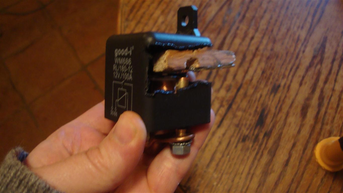

          Thanks Aaron, found the photos from Mario's thread, hm silver contacts huh oh well. But I see the roller and contacts probably a better idea than my state of the art concept I am innovating took hours at the machine shop I can send you the CAD files if you sign an NDA :Click image for larger version  Name:	DSC01670.JPG Views:	0 Size:	118.5 KB ID:	513366

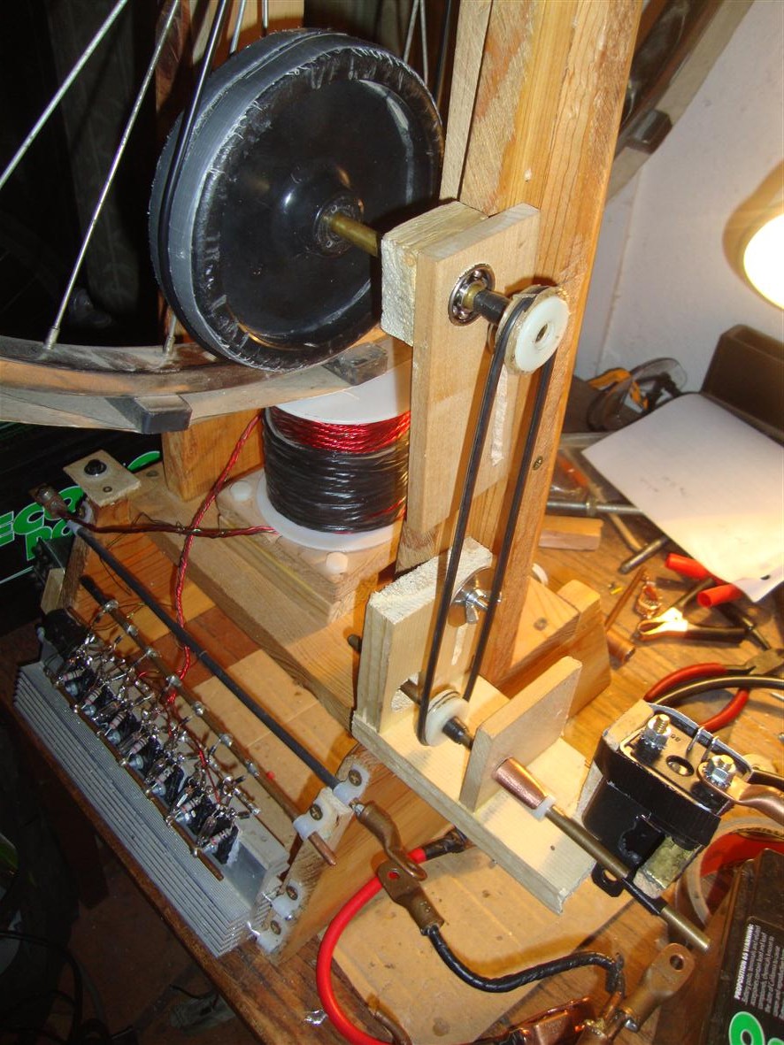

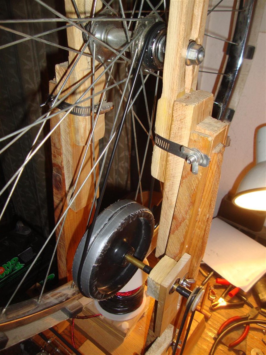

              Ok, trying that route my progress so far with a cart wheel and some bearings, shafts and large o ring belts. So far got the cart wheel to I hope spin reliably at about 60 rpm without losing the belt. Tight O rings arranged on the bicycle wheel hub seems to work ok as a poor man's groove for another o ring belt. Will post if it works eventually:

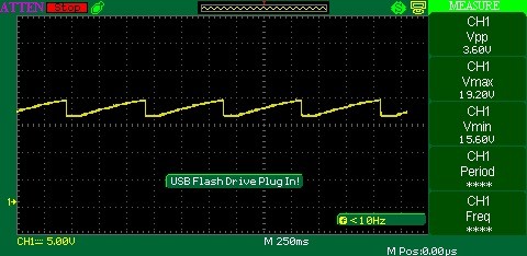

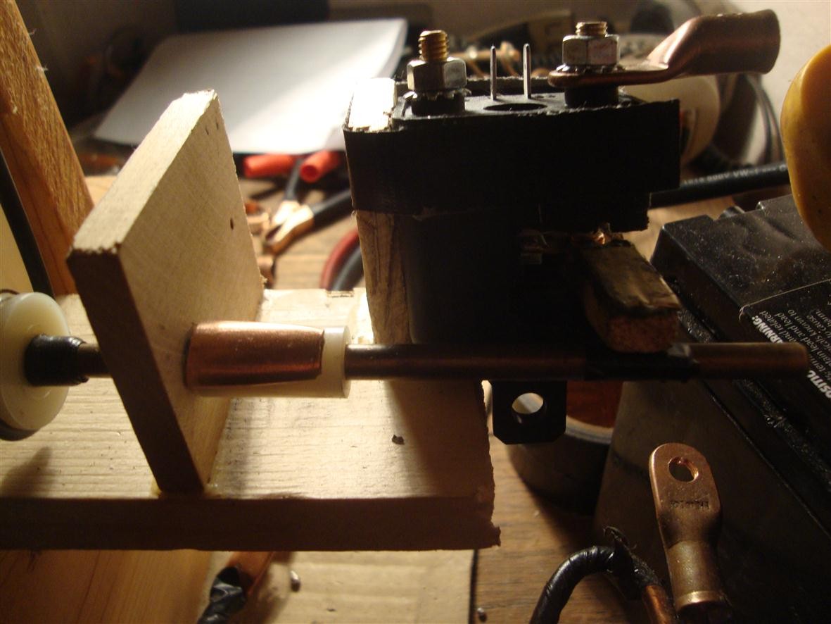

                Here's my cart wheel upside-down hacked into relay deal for the record. Ran for a few hours so far no problems. I can adjust the discharge a bit by moving the relay up and down relative to the cam wheel seem to be able to mitigate the time the capacitor stays at battery voltage. Happens to trigger at about 75 rpm which lets it build to about 18 V before discharge. You have to size the pulley wheels based on your stable SG rpm to get discharges per second (ratio of input wheel to output wheel to reduce or increase rpm), or you could double it with a double cam or use a smaller cam to push the relay etc.

                edit: some detail I made the pulley wheels from a cart wheel and two plastic discs from hardware store I cinched in a drill using a bolt and used a soldering gun to get a wide enough even enough groove--the belts are large o-rings from hardware store, the shafts are also from hardware store hobby brass pipe and a length of rod dunno where it came from bearings fit the shafts and wheels pretty well where it doesn't I wrapped electrical tape on the shaft to increase diameter. Used wood pieces glued together to hold the bearings to the frame with a single bolt and an adjustable area so I could move the shafts up and down on the frame a bit.
