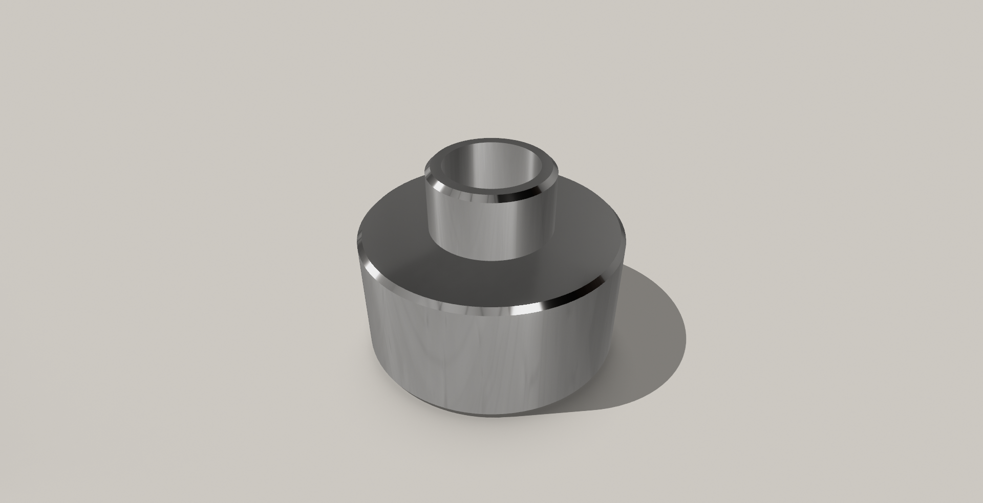

    One of the first problems I need to address is mounting the bicycle wheel on a 9mm axle. The bearings and split-shaft stop collars are 9mm. I designed this adapter to do the job.

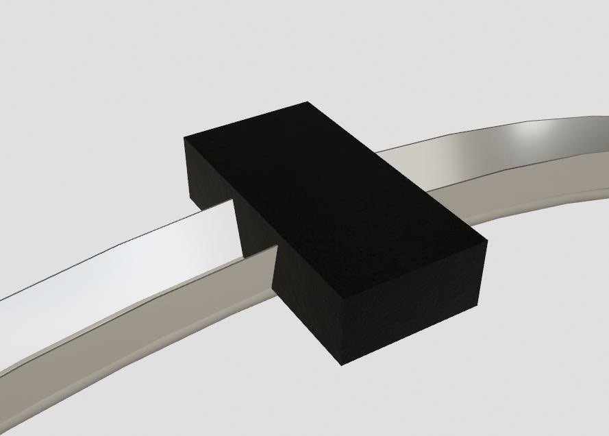

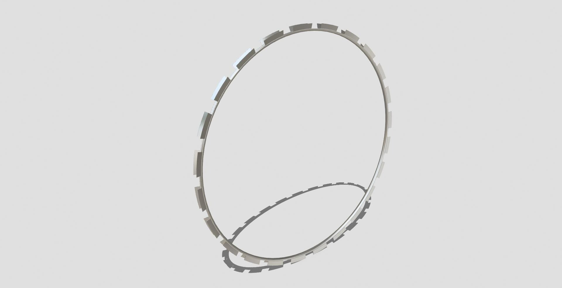

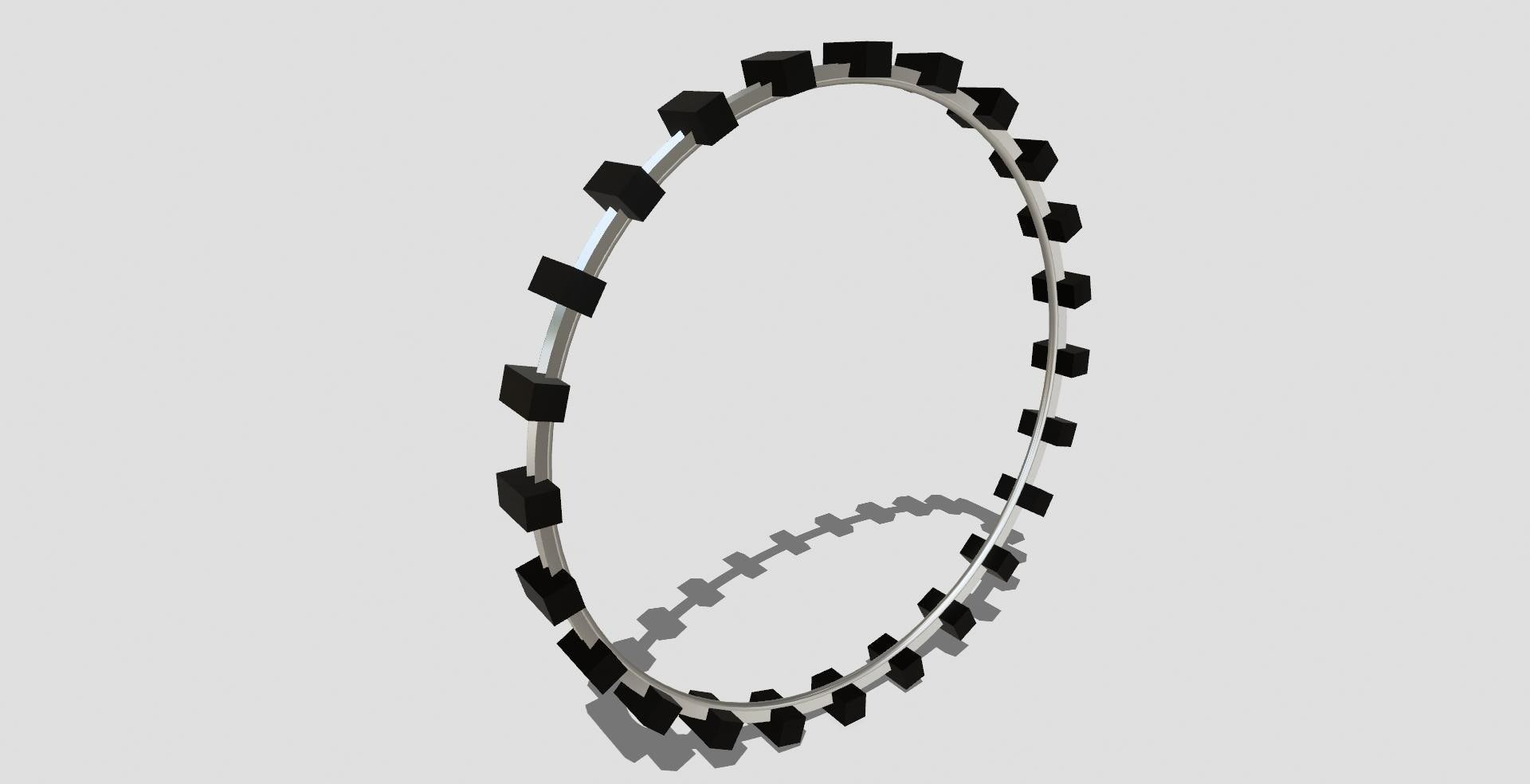

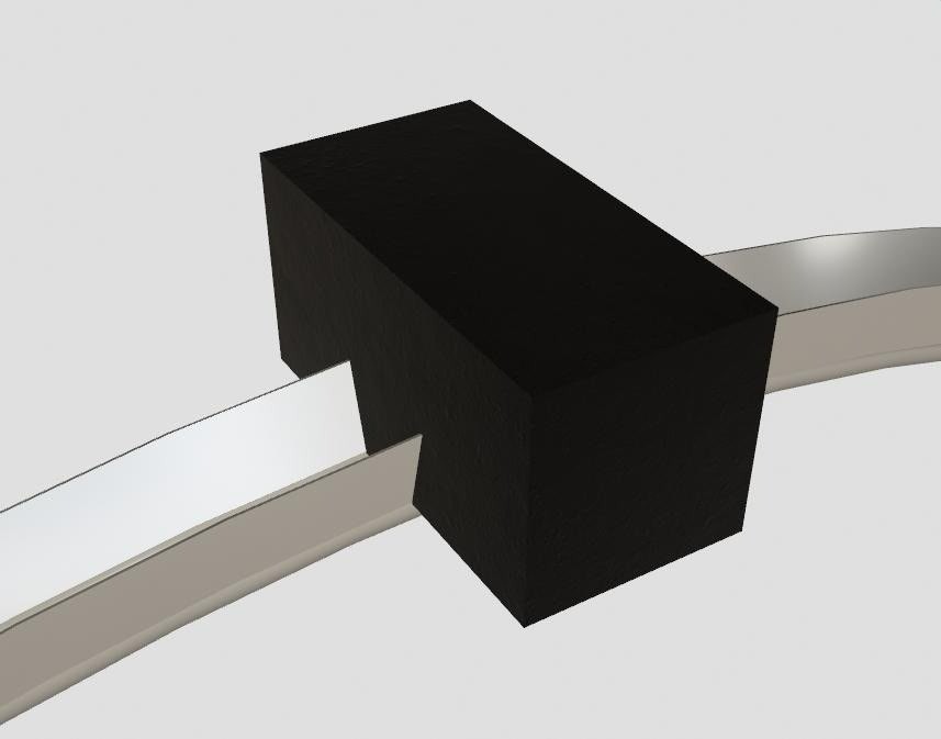

      The next problem I will need to address is accurately cutting the notches to receive double-stacked ceramic magnets in the wheel. See attachments for how the magnets will be attached.
        3D image of the wheel hub adapter
