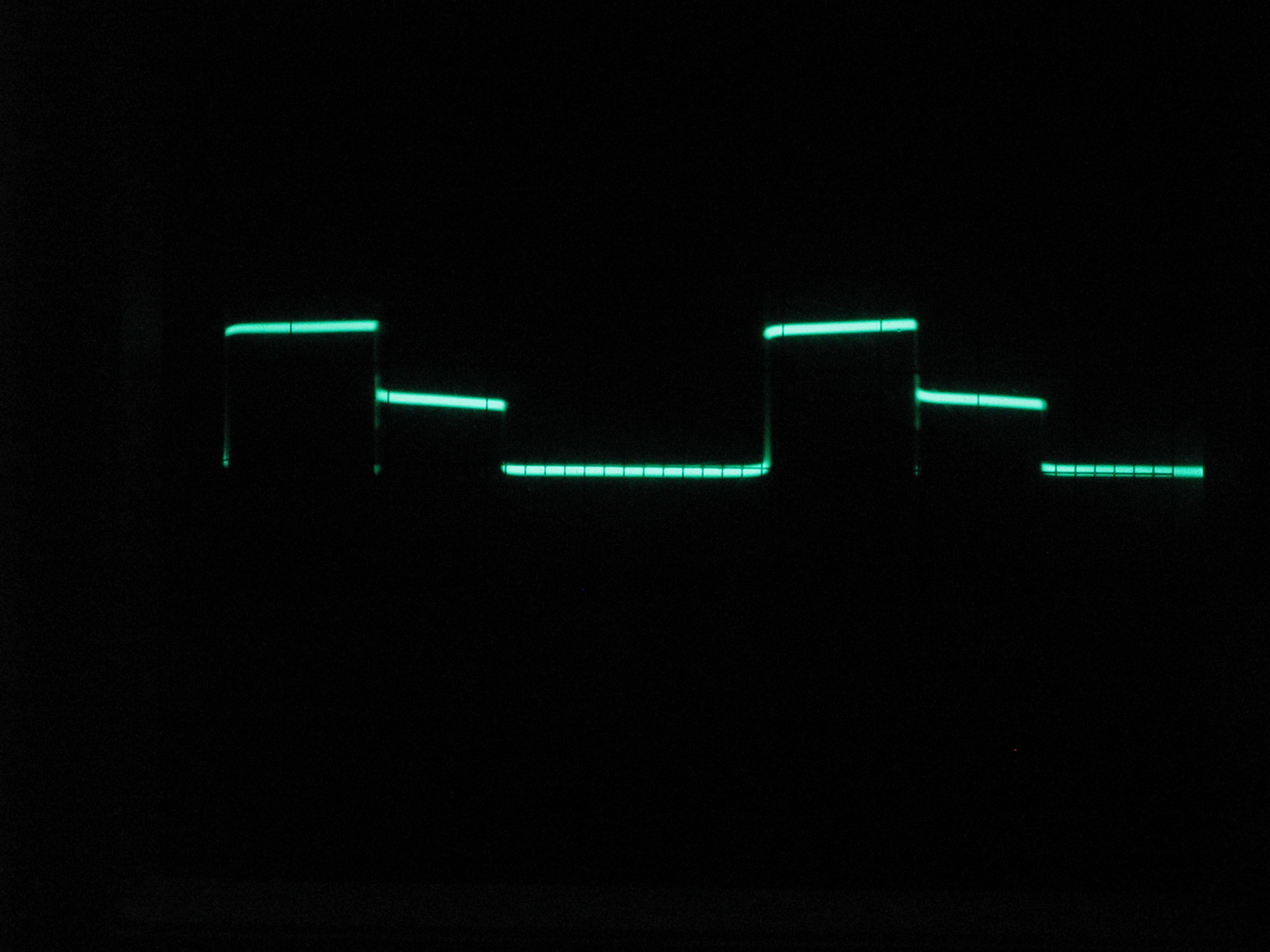

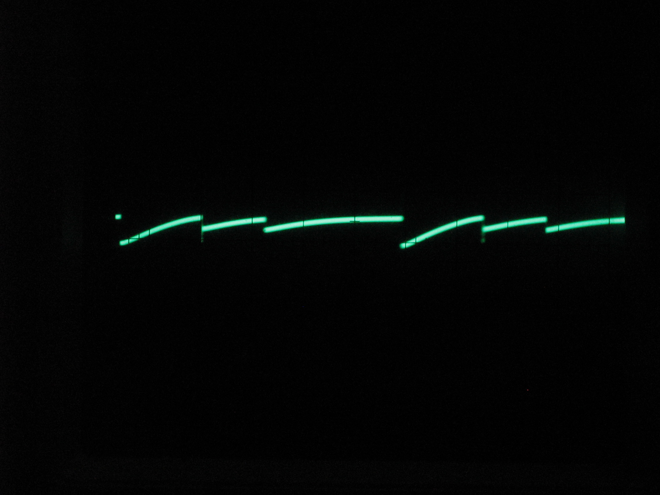

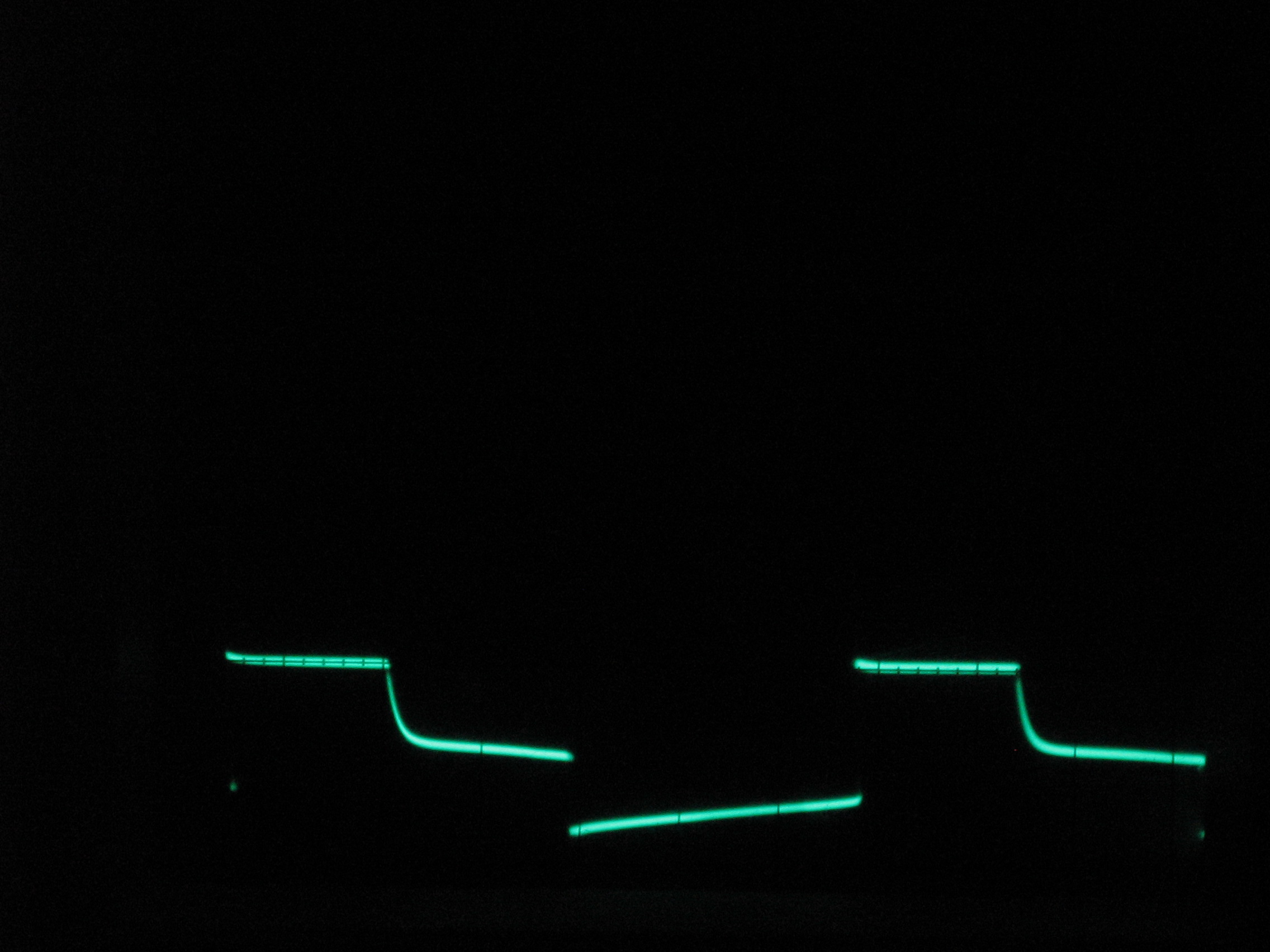

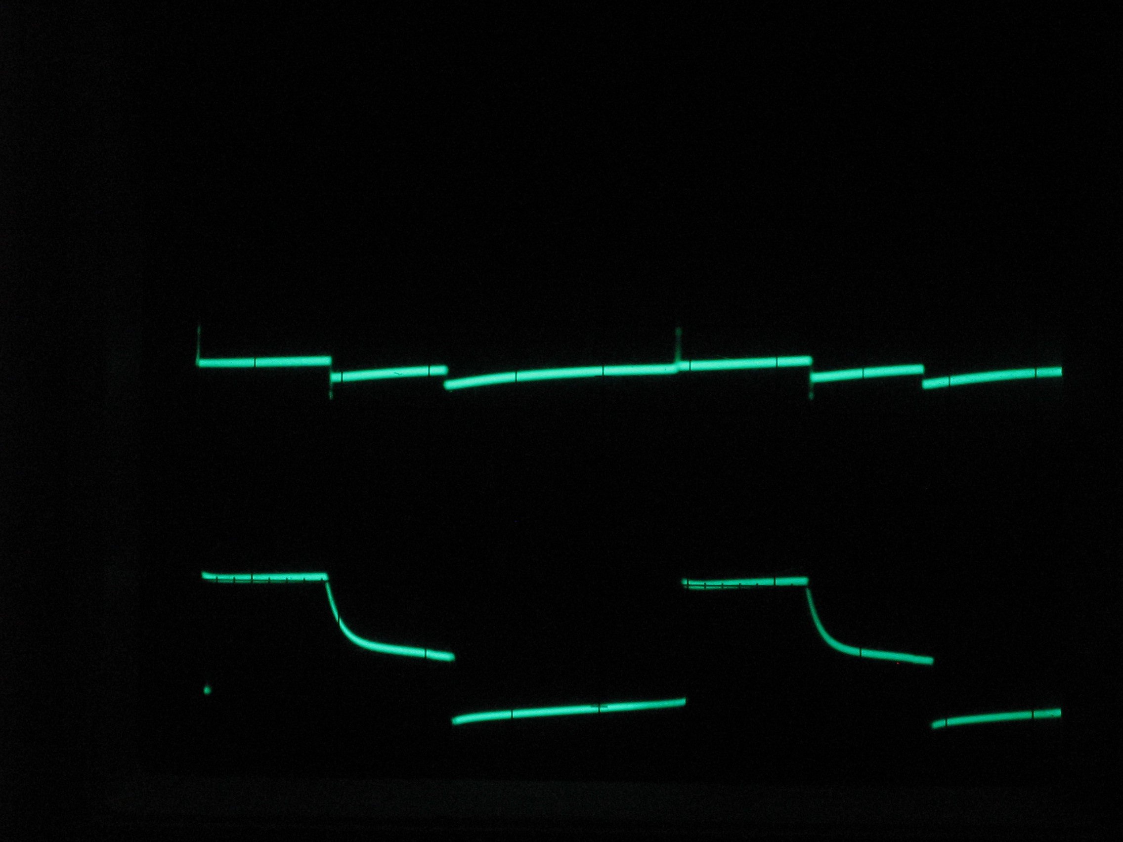

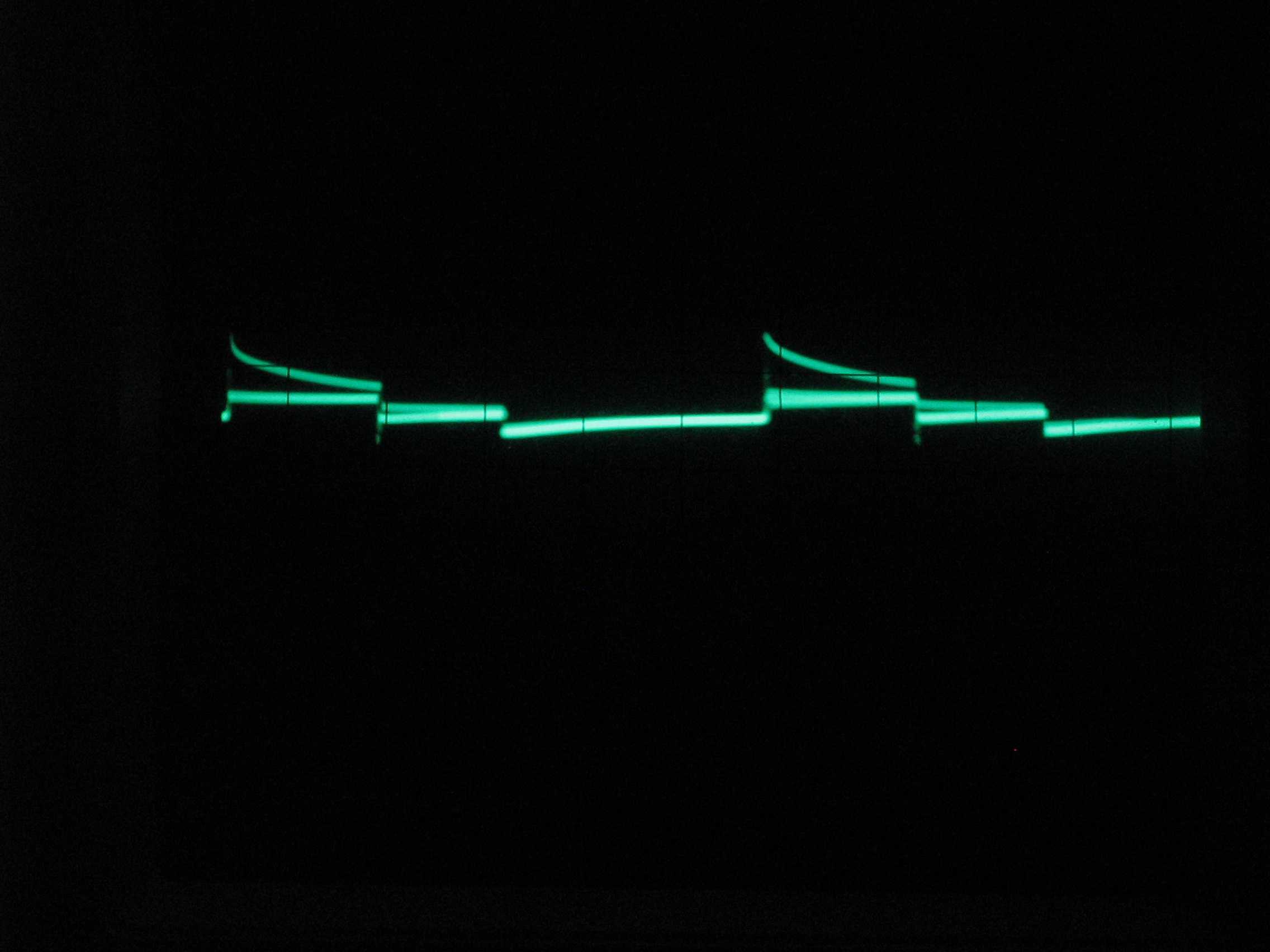

                            • @ Bit's, Kogs #204
                              G'Day Bits
                              Thank you for your quick reply and help I appreciate it.
                              I have closed all the gaps to 6.35mm and all the base resistors are 220 ohm I also have on each circuit board 1 47ohm I am running New Trojan 24v @225 ah as the primary and New Trojan 24v 450ah for the charging. I also have across the Primary Battery terminals (2 x 1000MFD -500v caps in parallel).
                              Today After setting all the gaps while I am charging the Normal Primary, I used 2 old truck batteries in series giving 24v to test how it made a difference.
                              The bulb was not lighted at all, and the pot was set at zero.
                              I noticed that the scope shot was different to when I last ran the machine So I scoped each Board and as the last board was different I scoped each transistor on it I photographed these shots.
                              I have tried to load these Photos
                              1 Bot=CB1 inclTrig , 10 Bot=CB1 Top=CB10, 12 Cb10 Tran2
                              photo1, Bot of scope shot,Top =Top of scope shot,CB10 = Circuit board, Tran = Transistor on board
                              The circuit boards have terminal blocks to connect the base resistors and the power strands from the coils. These terminal blocks seem to have caused problems as the screws have a slight shoulder underneath the head and do not seem to clamp the fine axle on the transistors or the power strands from each coil, I had to solder some small lugs on to the power strands.
                              I hope this is informative I can see now I really need to find out what is wrong with these boards.
                              Please what base resistors do you suggest I need for 24v?
                              Kindest Regards Kogs

                                We're gaining on improving your setup, it would appear. Not sure why you have the caps on the input drive batts at this stage. If you are using less than 48V to drive the machine, I would recommend putting 100 ohm resistors on the base while leaving the 47ohms on the boards. Without the machine running and the drive power applied, you can check voltages at each of the collectors to determine proper voltage levels. If they are not what they should be there may be a loose connection, enamel still on the conductor, etc. Once all levels are proper, your machine should run fine.
                                Jeff
