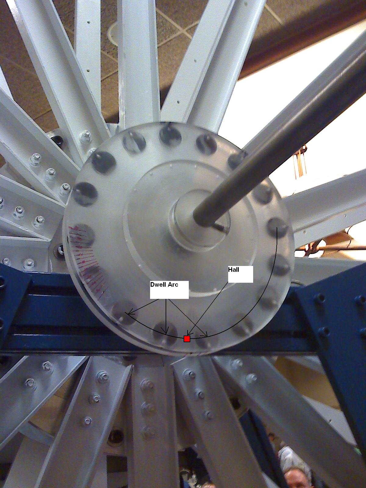

                  Bedini Big Motor
                  Picture of Dwell Arc and magnet spacing
                  John B
                    John B
                    Thanks John,
                    I couldnt figure why you didn't just place the hall on the perimeter of the wheel but now it makes sense. The dwell starts at 23 degrees before and after each big magnet.
                    John K
                    http://teslagenx.com
