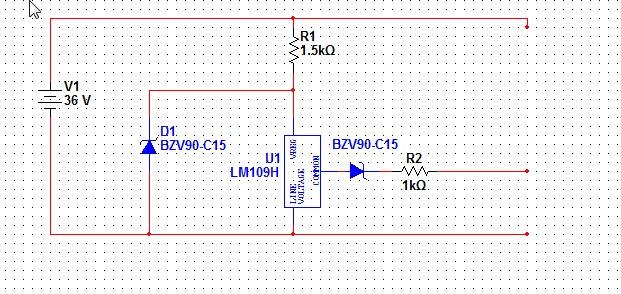

              • Itsu or John B,
                Can you please check to see if this is the way the zener should be connected? Reason being is that my circuit will not work properly this way. The way I see it is that the hall is getting 36V minus the voltage drop over the 1K5 resistor. This is causing the hall to self-trigger the circuit, when running at 36V.
                I just popped the last of the 3 halls that Ren sent me, so will have to order some more before I can test this any further.
                John K.
                Originally posted by Itsu View Post
                John K,
                i guess John B suggested to stabilize your Hall this way:
                Use a 15 V zener to keep the input of the hall at 15 V
                Nevermind the strange type for the hall, my database did not have a hall symbol.
                Regards Itsu

                • 15 Zener OK
                  Hi John K,
                  yes this is the "normal" way to connect a zener to stabilyze a voltage.
                  Make sure your zener is a 15V zener, that way, you should measure 15V on the input of your hall (pin 1).
                  As you have 36V from the battery, you need to lose 36-15=21 volts acros the 1.5K resistor, meaning 14mA.
                  So the zener and resistor should be able to handle that current.
                  Are you sure your hall can handle the 15V (instead of your earlier 12V)?
                  Regards Itsu
                  • Hi John K,
                    Most of the linear Hall sensor ICs have an open collector output and whenever this output transistor is OFF its collector receives the full 36V (which can be any voltage up 38-39V in practice from three series batteries) and most probably this high voltage burns the output transistor (maximum breakdown voltage is exceeded too much).
                    The solution is to use a second 15V Zener diode in series with pin 3 output (the open collector), which will block at least half of the 36V+ battery voltage that comes in via R1 and R2 resistors (I refer to this schematic here:
                    http://www.energeticforum.com/attach...i-3gt-v1.2.pdf ).
                    This way both the supply Pin 1 and outpin Pin 3 can receive a maximum of 15V DC voltage, effectively save the Hall device from 36V+.
                    I just read Itsu post above. He is right when the Hall device just conducts current via Pin 3 but when it does not, the total 36V is present at Pin 3 via R1 and R2.
                    Gyula
                    EDIT: even a 20 or 22V Zener diode would be best instead of the 15V diode I suggested above.
                    • Originally posted by John_K View Post
                      Itsu or John B,
                      John K.
                      John K,
                      I am not sure about the data on your hall but the 3120 from jameco is rated at a fan out of 7. so it should handle a mps Ao6 just fine. but with a 750 ohm across the collector should reduce the current in the base as I think was suggested. and that should have solved the problem if that transistor is pulling to much current. I would think putting a zener in series on the output of hall might change the timing to much or alter the overall operation. sorry for piping in here but it looks like your little transistor is what's giving you the trouble.
                      Les

                              • Thanks all
                                Thanks all for your responses.
                                The hall I was using was a 24V SS443A:
                                SS443A pdf, SS443A description, SS443A datasheets, SS443A view ::: ALLDATASHEET :::
                                The 15V Zener I am using is a 1N4744:
                                The hall triggers a MJE2955, which then fires the MJL21193/94 pair.
                                I will order the ATS137 as John B suggested, looks like they are the same one Rick sells. http://www.diodes.com/datasheets/ATS137.pdf
                                John K.
