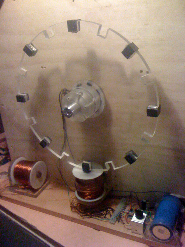

    • Hi John K and David.
      I got my device up and running last night. Its built using what I have laying around so its not up to 3gt spec. But it is the half circuit, triggered by a hall. Im running on 24v, 200-300ma, 8 pole rotor 500mm in diameter.
      Coil is 6 filar, each strand 0.9mm @ 2.1ohms per strand. I presently have it running with 4 strands in parallel. I had some heat in my circuit, particularly the PNP and I got rid of most of it by adding a rheostat off the 220 ohms which was discussed before. Even with the rheostat at its lowest setting (effectively adding very little if any resistance) the heat generated is considerably less, barely warm to the touch now. Tweaking this resistance lowers the input current even more. Not that there is much current here when its up to speed anyway.
      Charges a 2200uF cap up pretty fast, still have to build the discharge circuit.
      Took a little time to get the hall in the right place. I couldnt figure out why it would work then get slower and slower and eventually stop. I eventually found that there was a spacer missing, so the timing disc on the shaft would slowly get further and further away from the hall, eventually switching off altogether. When I have made up the spacer for it I will post a vid.

            • Bedini 3GT
              Hi Ren,
              Looking good mate! I'll try the pot in series with the 220R when I'm up and running again. I imagine a 500R 1W pot would do there?

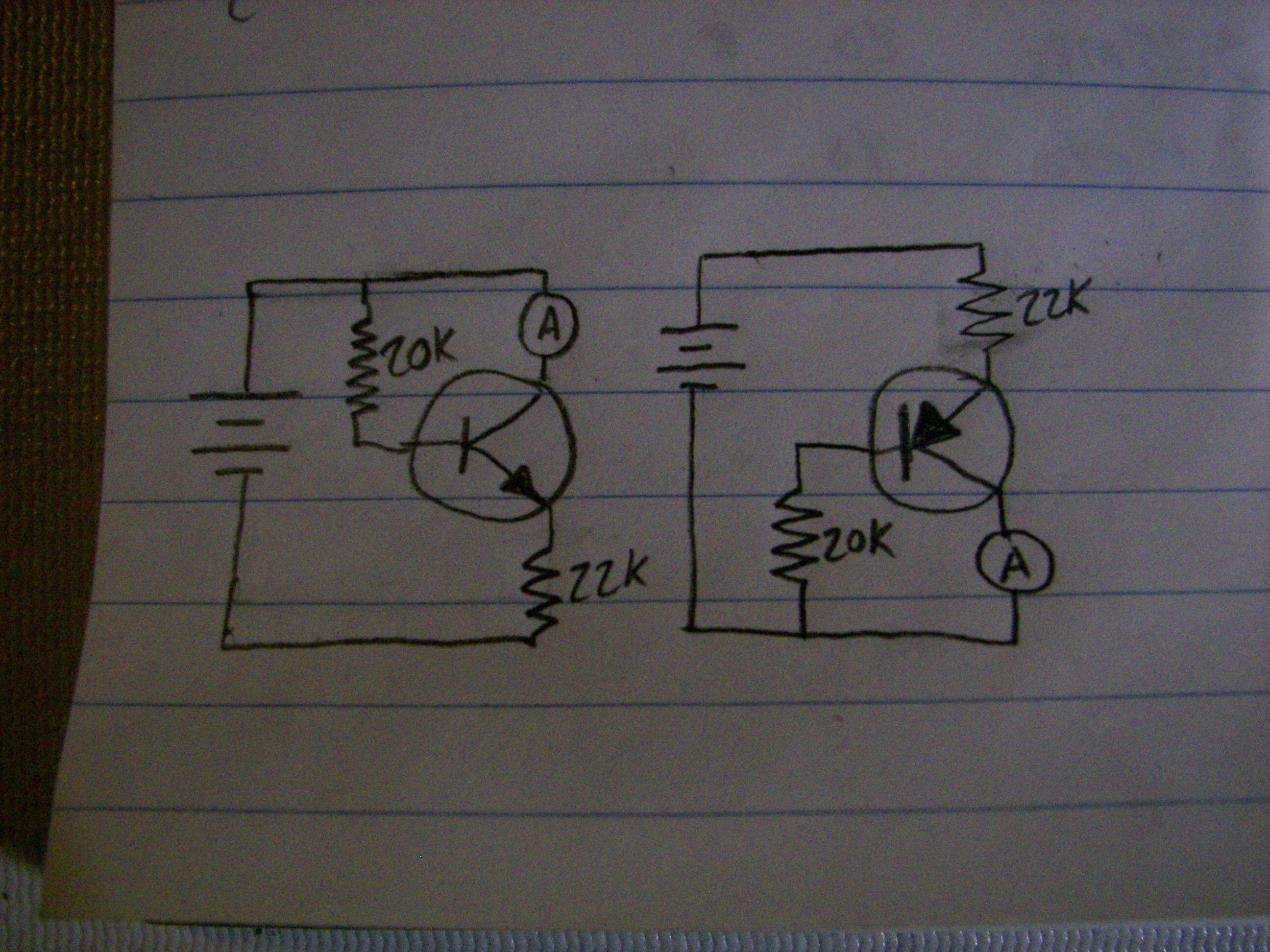

                    • beta test circuit
                      John B, nice Flintstone battery
                      very cool!
                      Is this right?

                        • Originally posted by John_K View Post
                          Hi Ren,
                          Happy Australia Day!
                          John K.
                          I used 1k 20w because its what I had. 500R should do nicely.
                          Happy Australia Day right back at ya, Im being very un-Australian and working so have some for me.

                                Thanks Wrench76,
                                I going to match some now.
