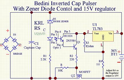

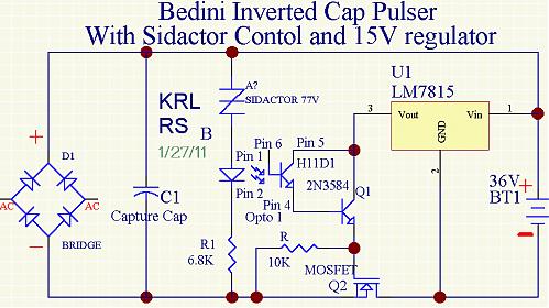

3rd, I have been trying to understand what you mean by using a regulator on the cap pulser circuit that you told Brent about....
This is what I've come up with..... but don't think that it is correct....
Or should the Gnd of the regulator go to the neg of the capture cap and the Vin pin go to the neg of the battery.....?
The LM7815 can only handle 35V input, so it will not work there as shown, but another 3V - 120V variable regulator will work there.
please confirm if this is what you meant, or not.......

RS,
I'm not ticked off at you.
You have this right. it's just a matter of testing the circuit and showing the pulses to the battery. Good work. Also put a 220 ohm resistor in series with the gate. Sorry about adding things but I have my moments.
Ok 2.2 K resistor with a zener will work better. You could add a resistor to pin 2 to ground too.
RS ,
I see the problem you must move the regulator off the output battery, then move it to the cap minus. or just use a zener with a resistor to limit the gate. I should have seen that , but I'm doing fifty things here right now at once.
John B

Originally posted by RS_ View PostHi JB,
First, Thank you for every word you have ever told me....
I have done my best to build everything, within my means, and understanding........ Some of it worked real good, and some of it so, so.......
2nd, Sorry if I've ticked ya off by posting the wrong wire length info,
or anything else in the past that that has happened, or not happened as planed.....
Thanks for everything........

Nice scematic RC.Originally posted by RS_ View PostThanks JB,
Here is a new Sch with the changes and Zener per your edit.
The TL783 is 1.25V to 120V at 700ma, should provide enough current to pull up most Mosfet gates at 15V.
Now I need to go dig one out of my parts cabinet, and rig it up to test......
RS
