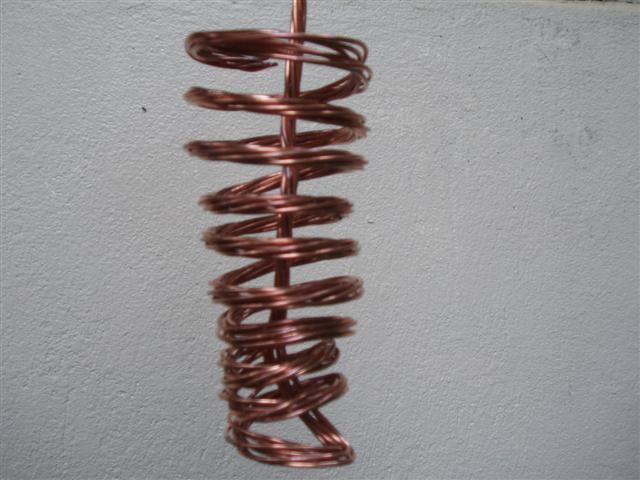

The picture below is of the shape of the copper anodes that have given me the highest output, (when using copper anodes), this can also be heated up to be made into the semiconductor, but I have not tried that yet.
