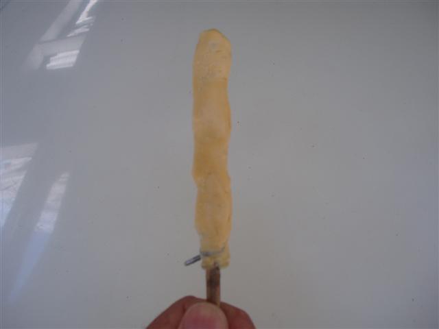

                        • Hot Dog On A Stick- table salt/glue cell- update
                          Ib2 and All:
                          Isn't it better to use no water, at all? As sooner or later, as you've mentioned, the water or any other liquids containing water will win out, and get their way. No water no cry...
                          BTW: The table salt cell I call the "Hot Dog on a Stick" cell, is putting out a nice voltage after all, and still dripping water. It actually works pretty well, if I can deal with the mess it makes. It would probably do even better if it was sealed in resin, once its had a chance to dry some more, if it ever will, I'll seal it. Instead of burning water, like some cells do, it may actually be making water.
