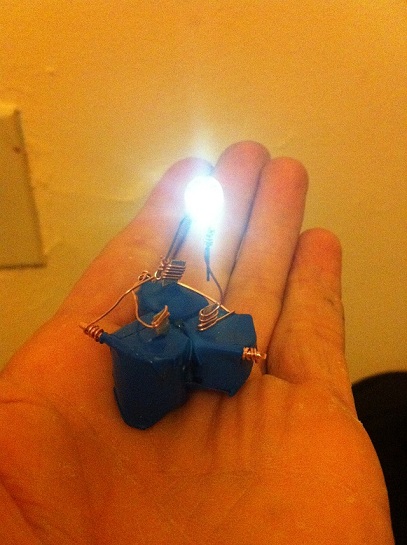

            • Bioplastic Carbon Cell
              Originally posted by plengo View Post
              So far I have some interesting results. With the carbon cell I have more voltage and current for sure. I did a cell that is very wet and although it provides lots of currents it totally corrodes the Mg.
              A dry cell, or dry after the first wet (or activation) is the best. I corrodes about 1/2 mm on the surface of the Mg and than it stops while continue providing a good 4ma or more of current continuously at a good voltage too.
              Adding very tiny amounts of water carefully on the carbon or mix and avoiding the Mg surface works very, very well.
              Too much water totally destroys the carbon/mix crystalline structure killing the cell permanently, very interesting finding. Silica seams to be, in very small quantities, important to give some structure strength to the mix.
              Another important finding is that on the first wetting of the cell (activation) some ammonia is formed which is NOT good for the cell and causes corrosion of everything. Once that first ammonia gas is evaporated the cell starts working the best. So some form of initial ventilation seems important here, at least in my cells.
              Fausto.
              Fausto
              Your carbon mix with the bioplastic shown in my last video is surpassing all my expectations. Time to replace the Mg ribbon with Mg rod. I will post an update video in a few days showing the results of this experiment. Thank you Sir.

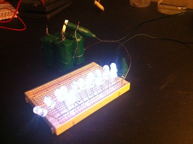

              • carbon mix
                I also had great results with the carbon-alum-sod. silicate mix, will be doing some tests with variations on this mix,... i grinded the mix very very fine untill it tuned to dust and it seems to work better, i have to agree with plengo here, quartz is a good addition... the first cell i made has been running for 17 days now and have only had to water it 3 times, it lasts abut 5 days with no water. that one has epsom-rochelle salts at equal ratio and a small amount of quartz grinded really fine. nice work, im very exited, just joined the forum a week ago and very happy to see all this great group work, every thread is a step closer, thank you all.
                the picture with the 12 LEDs is the carbon mix by plengo, grinded to dust, and the one LED is my first mix rocchelle-epsom-quartz... cheers
