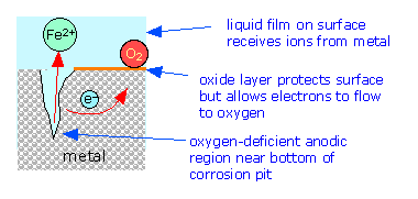

              • @Ibpointless:
                I must respectfully disagree with your findings that oxygen is a bad thing. I am coming from from the experience of galvanic cells, so if you disagree with me, that is quite OK.
                From the site:
                Chem1 Electrochemistry: Electrochemical corrosion
                Pitting corrosion
                Most metals are covered with a thin oxide film which inhibits anodic dissolution. When corrosion does occur, it sometimes hollows out a narrow hole or pit in the metal. The bottoms of these pits tend to be deprived of oxygen, thus promoting further growth of the pit into the metal.

                  b rads,
                  That is why I disagree also. We could take this further as I have also seen impieties in the metal that generate little currents in the pits. as the impurities produce a type of acid gets stronger and stronger and then metal goes real fast. Thanks for posting that. The oxide really does not hurt anything as I have seen.
                  John B

                    I respect your disagreement and you do bring up a good point.
                    Some metals don't need oxygen to rust. It looks like theirs many types of corrosion.
                    "Rusting is the common term for corrosion of iron and its alloys, such as steel. Many other metals undergo equivalent corrosion, but the resulting oxides are not commonly called rust." Rust - Wikipedia, the free encyclopedia
                    oxidising is just another form of corrosion. Some metals develop a oxide layer like aluminum to protect it. The oxide layer is not reactive but can allow electrons to flow. The oxide layer on aluminum is great! but magnesium oxide is not so great, its not conductive. "MgO is used as an insulator in industrial cables" Magnesium oxide - Wikipedia, the free encyclopedia
                    @bedini, the jelly is not that great. It does help stop corrosion but its just not that great. Bubbles still show up over time but it was a fun test to do and I hope its given me some in-sight for future builds.
