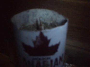

    • Curing
      Here is a not very good picture of my cement battery curing on the sauna rocks. In the tradition of John B. using a beer can even though I don't drink
      alcohol. Mix includes alum, calcium carbonate, zinc gluconate, magnesium.
      Used a 2 inch piece of copper pipe with copper tubing from an old
      thermocouple wrapped around it. Also added extra pieces of aluminum inside the can since it was so thin. Did not have sand so crushed up some sauna rock
      and mixed that in.
