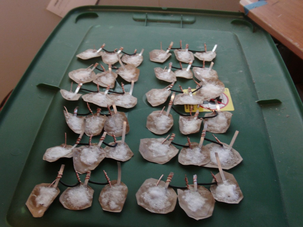

    • I've been really busy with work but I have been able to make a Crystal glue cell panel. Each group has 3 cells in series which gives me 4.20 volts and it has 12 groups. I've gotten a little better at making these cells and instead one single cell giving me barely 20uA I now got some that give me 100uA or more. In that panel the lowest producing cell is at 45uA and I have quite a few high producers giving me close to 200uA. Each cell is a little bigger than a quarter. But this is still not good enough power. So now I'm working a super thin version that is made of paper and aluminum foil, I can make this very long and then roll it up so that it applies pressure.
      Does anyone know where I can get a block of graphite?
