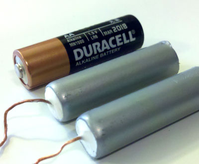

I am trying to replicate the AA battery model as much as possible because most of the things I would use these batteries for, would power small devices. Being that I don't have Mg on hand, I'm working with steel screws inside this tubing.
I placed a mixture of epsom salt on a piece of paper towel and insulated the screw with it. I fired a coil of copper and wrapped that around the paper towel tightly (since we all like the pressure). I added water once, put electrical tape around it and slid it inside these tubes. I made sure both ends had protruding electrodes and filled in the rest with silicone.
These aren't going to do much because I'm not using Mg, but just wanted to see a prototype using this method. I'm getting around 1volt and 5-10mA. I would like to see how long they will last without adding more water. I'm sure they will die out, but I want to take a very small drill bit near the negative end to access the paper towel and induct water into the cell again.
I'll keep you posted on how long it lasts.
