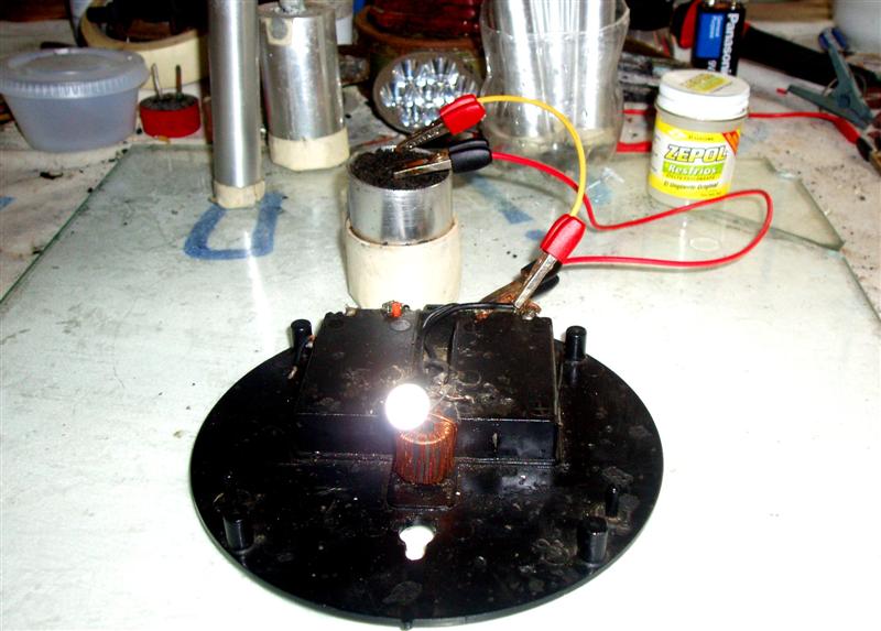

Here's it is, now on test on a 'Penny' type oscillator, with regular copper (non burnt). Flash rate approx 5Hz and a little brighter than the instant caught in the pic

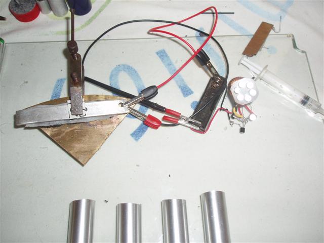

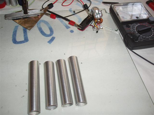

I've mentioned previously that I have been using aluminum and activated carbon for my cells for a while now, months. All my cells are aluminum/C, But, as Slider also has shown, they only put out about a volt or less, and not the 1.6 volts as is stated in Chemalloy tests. This higher output needs to be confirmed, maybe it's true.
Although my cells reach 75mA, and most start at around 50-70mAs, then drop somewhat in time. The current levels are totally dependent of the surface area of the carbon electrolyte, and size of the Al tubes.
My aluminum tubes are made from some kind of alloy also, and are additionally anodized with a clear coating to protect them from oxidation.
I use them because they are free and available to me, and they do work well. But an additional cell needs to be used like 4 cells instead of 3, to make up for their lower voltage output. My oscillators work fine even with one of these cells at about 0.65 volts, loaded, as these cells do have some fairly good current to them, and that is what the oscillators need, and not much voltage.
Just one of my cells has more current than the solar cells that come in the garden lights, and work even better than a single solar cells on an oscillator.
The solar garden light cells that I use output are 4.2 volts and 30mAs.
And of course the homemade cells will work day and night 24/7, and are already months old of daily or nightly use running night lights, and oscillators.
As all of these kinds of cells are of low output, they also need to be low cost, or they will not be cost effective to use. Compare to the 12 cents for 7 weeks running that Brad is kindly telling us about.
Aluminum and carbon are both almost free, and available most anywhere in the world. I also use beach sand which is nearby and is as free as it gets.
The borax treatment of the aluminum may help, but it is something that I have not tried. Maybe someone can let me know how borax or other semiconductor layer treatments has worked on the aluminum for you.
Brad: I've now made an new oscillator core using the #28 wire, 18 winds, (two separate winds), L1 and L2 , on a small 1/2" ferrite toroid that comes in the CFL bulbs. So, this is similar to what you've shown, and this is to try to replicate the results that you've gotten on the LS low draw oscillator. I'm now just waiting for new 2n2222 transistors to be delivered today, and will let you know how it all goes with the new set up, which I am very hopeful about.
