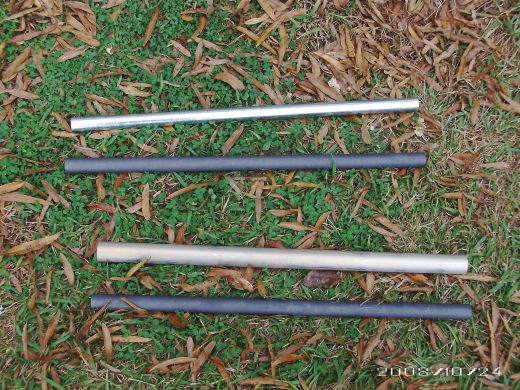

)these are Hard fired and not that brittle . the graphite is very hard .they can be made with a wire in the middle of them for electrical connect .

Yes i pull up the rods in 6 months. the carbon and graphite is pristine and the zinc and magnesium are slightly whitish when i washed the clay off . the magnesium is slightly pitted but the bottoms are still sharp so far . compared to my other house/lot about a mile away mostly sand the rods over there are still running lights outside thru a Jt and they have been in the ground for a few years . i pulled one up a few weeks (magnesium)ago and am using it for the air battery . It was slightly pitted and the bottoms were ragged a bit on the metals ,the carbon was pristine . i just took some windex and a piece of steel wool and it was shiny in no time . very little loss . © 2007–2026 A & P Electronic Media and its licensors · posts © their authors · Copyright & Archive Policy
