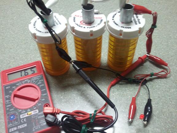

                      Checking back on my records, I made 3 cells on Sept. 21, 2010. These 3 cells are made from copper wire, galvanized conduit, and tap water. It is my understanding that as the zinc is consumed in the galvanic process it is changed to zinc oxide. The containers are about a quarter full with white powder. When you look up ZnO, you will find that it has some pretty nifty properties. These 3 cells, short 6 days, have been lighting a red LED nonstop for one year. I suspect that after a substantial amount of the ZnO has been created, other reactions are happening in the cells as the water level can drop below a half and the LED does not suffer. Therefore, I agree that we can and must control ion transfer; a low output 10 year cell would be pretty nice in my thinking.
                      Brad S
