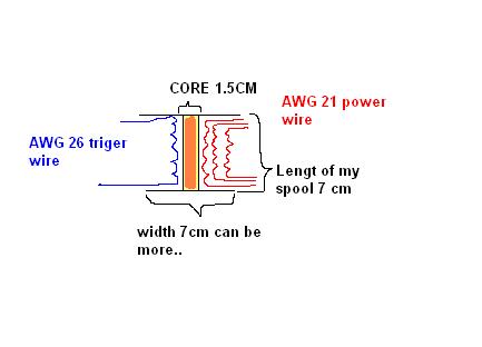

              hello my idea is as follows
              multistrand BEDINI with rotor
              Trigger wire is 26 awg and 21 awg power wire
              wire is 36-40 meters long,,
              minimal 3x power wire max around 5-6x
              Coil size is my Spool sufficient?
              have a width of 7 cm and 7 cm length to
              core 1.5 cm
              tranzistor i wille tip 41c then later mjl21194
              how many turns should have a coil? 800-1000 ??
                core 1.5 cm
                I would suggest to stay within 2 sizes apart between trigger and power coils, eg. #23/#21.
                I would use 100 -120' of each wire. (36 -40m is ok)
                Your spool is fine and you should be able to fit 6 twisted wires on it. Core diameter of 1.5cm is fine.
                Make sure you have good core material such as 1.5mm iron welding rods. There is no need to coat them with paint or lacquer individually but secure the bundle in the spool with good epoxy. Any loose piece may get pulled out and ruin your rotor, magnets and spools. Same applies to the magnets. Even with good glue it doesn't hurt to wrap your rotor around with good reinforced tape.
                Change your transistor to MJL21194 as soon as you can. TIP41 is really poor and will affect performance. More prone to "sudden death syndrome" too.
                You'll have to experiment with base resistance to find a "sweet spot". Once determined I would replace the pot with 5 - 10W resistor and small bulb.

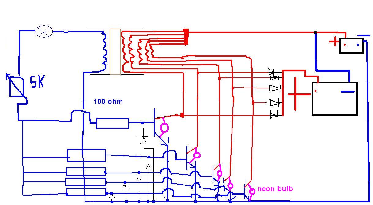

                            oKej
                            yesterday i wound my coil around 40meters wire ,1x triger 5x power coil twisted in to one cable ...
                            today i construct my circuit this is my "scheme"
                            my s chceme is corect or have better scheme ??
                            tranzistor maybe 3055 for test
                            I need to buy mjl21194
