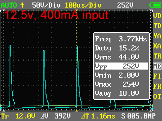

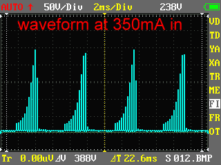

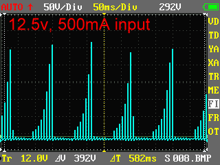

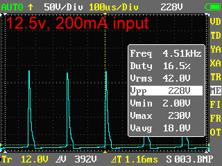

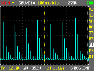

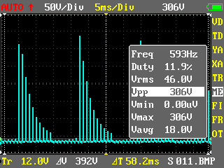

    Hi, been experimenting with some mods to a basic bedini solid-state and would welcome some input. I can wind up the voltage (with 12.5v input) to well over 500v P-P going out to the chg battery.(12v 270cca). My problem is, there is virtually no amperage going into the charge batt.. Is that an issue? At 12.5v/750mA in, I get 300+v out, but only at 100-120mA! I have wound output voltage up to over 500v p-p, but still not much current. Hopefully have attached some scope pics.
    The pulse looks really nice.
    can you describe the coil ?
      It's a tri-filar, twisted together before coiling. .67mm copper. 50mt per length, wound onto an old fishing spool. (40mm core, 75mm dia.) I measured 2.7 ohms per coil. It stays cool, no heat generated at all. I guess the no current bit does that. I'm using an MJE3009 for the NPN and an 856 for the diode. I only have 3 watt resistors for the VR and base, but they get a little too hot for my liking... Rob
