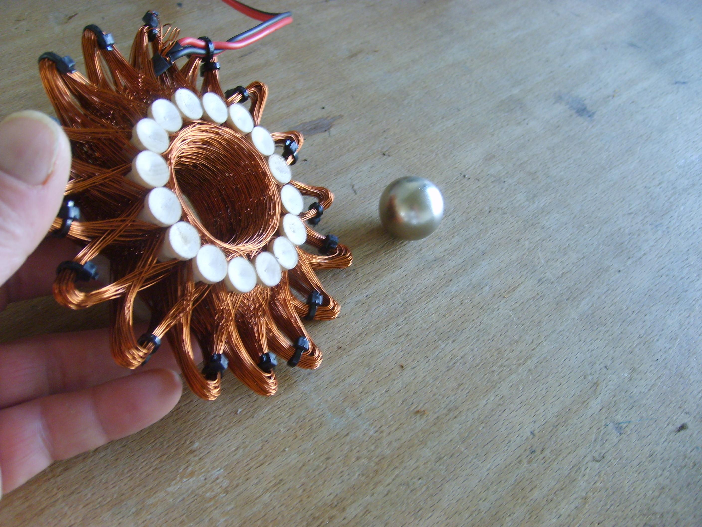

            Hi guys,
            I agree there is nothing special about Bedini circuits, I built many devices all solid state resonant, even designed a PCB for it, lots of spikes, could go as high as 1 kV, but never I got more than COP=1 (swapping batteries over and over again)
            But this guy claims to have 20x higher spikes at 1 specific frequency on this rodin starship coil.
            So I am building one now and will hook it to my PWM, see what happens.

                hi guys,
                here some results from testing:
                - tested with mosfet pulsing frequency 1Khz - 1 Mhz
                - tested with scoop on output diode
                - with a frequencycounter
                - 17Ah batt.
                - charging at best on 70kHz pulses 30V 1A input (1.5V above batt.voltage)
                - scoop pulse max 8V (the guy in video mentions 75V pulses!)
                - 3 large stacked neodynium
                - charging without neodynium is better
                - no frequency found where pulses are 20x higher
                this evening I visit the guy from the video, so I will learn more hopefully!

                        I talked to the guy yesterday.
                        I asked him what it was he all got excited about.
                        He said, I couldnt get the circuit to run, then I suddenly put magnet in the coil and the battery start charging.
                        He did not have a PWM, only a signalgenerator.
                        What I was curious about (i checked his scope /probe settings) that his spikes were 40 volts above battery voltage. He said he even got higher up to 75 volts !
                        In my replication I only got 4 volts above batt. voltage (30V 1A input)
                        anyone?

                            There are no scopeshots in the video. Yesterday I saw it with my own eyes (forgot to take cam shots )
                            Freq. was 6.2 Khz, mosfet was not warm at all, coil and magnet were warm.
                            I changed frequency a little bit, but spikes kept the same height. (I expected some resonance effect, but this was not the case)
                            The only thing I could not check was input amps. (input was a 12v deepcycle batt, 100Ah)
