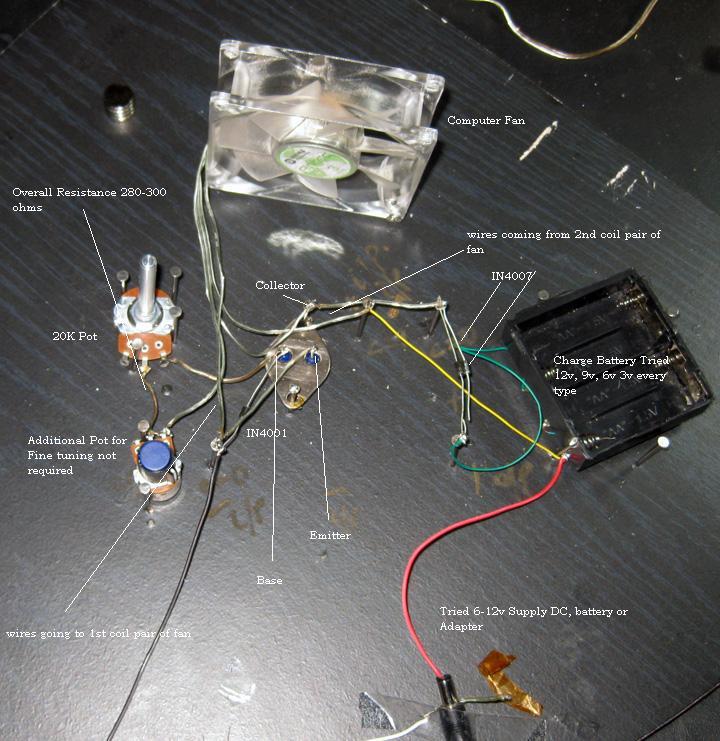

I tryed to stay close to this setup, but there is a problem. As soon as i power up the circuit, the coil sings in different pitches. I measure around 13V across both coils in AC position of meter, rotor not spinning. The coil atracts the magnet and the sound is loudest when the magnet is centered in front of the coil.
I use a 3055 transistor. Coil is 800 turns, 0.63mm run / 0,3mm trigger. No core till now. Two 12V car batteries.
Would someone go with me through a troubelshooting? I realy would appreciate it! I would like to try some things but need a working base of course.
