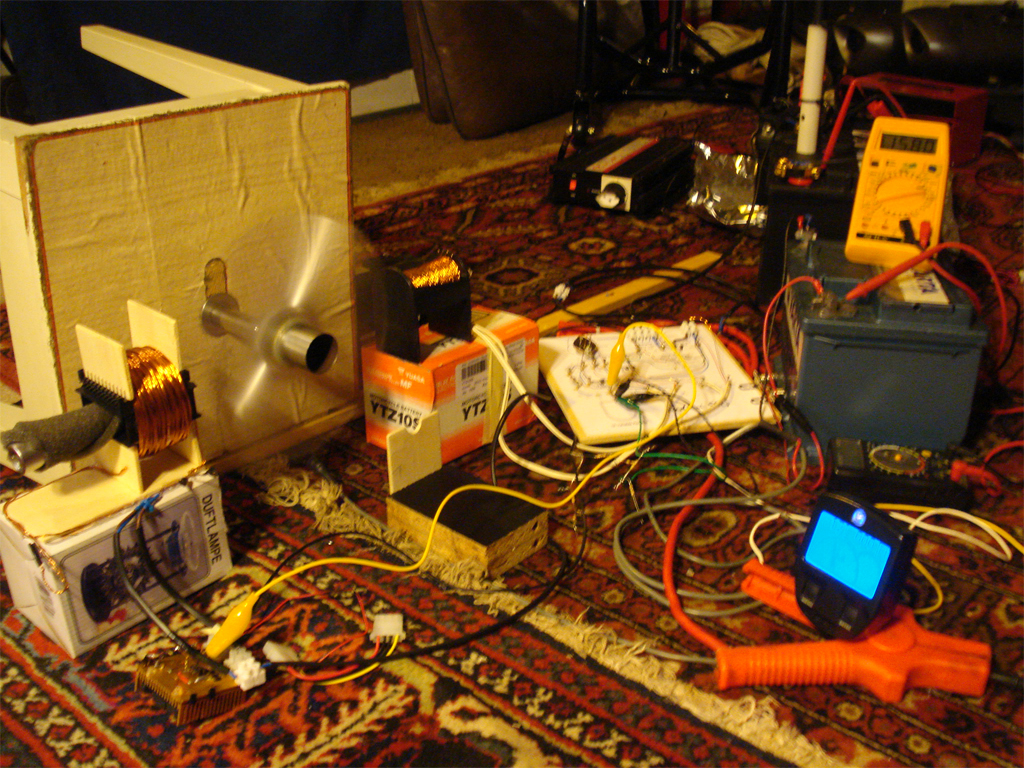

Version 1 was a home built 175mm diameter rotor from wood/aluminium with 6 neo magnets and one coil 800 turns bifilar.

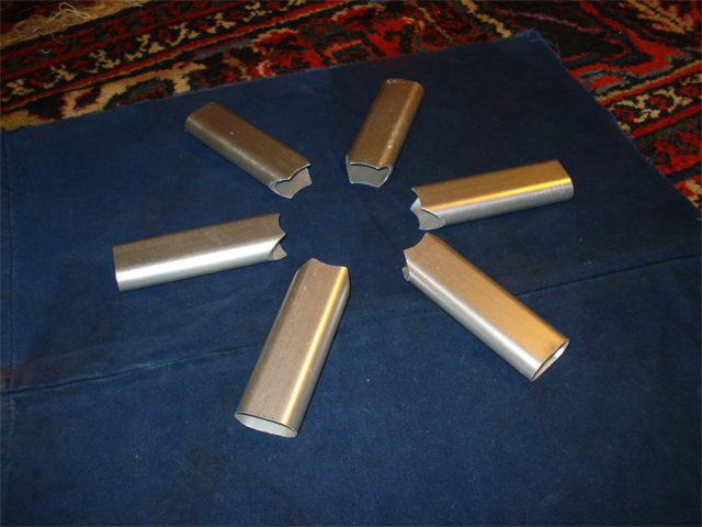

Run and charging battery are car starter batteries. I discovered that here has to be a ratio between machine size (number of coils, ampere draw) and battery capacity. Because my route in mind leads in direction to a 17" casted alu wheel wich has weight, i made a something bigger rotor out from oval shaped alu profile.
I now had 225mm diameter but all from alu, very lightweight. A better 'throttle' response and some higher rpm's were trying to catch the liking of a racer heart, but... it feels like you have to give more to hold the rotor on speed. Seeing the difference, i had to conclude, the wheel has to almost turn by itself wich needs some mass to overcome the time when no driving force is acting on it.
It's the same as on my bikes motor, wich has an uneven firing sequence. It needed more rotating mass to compensate for that, although oscillating or rotating mass is hated like pest in this segment.
The second difference beside mass is the spacing between magnets. Bigger rotor and same number of magnets = more time between impulses. To test for each component counts for what, i used the bigger lightweight rotor, but the magnets are at - 1,5 cm diameter placed. This felt better then before. So i asume my magnets shouldn't be further spaced then they were at Start, what was 9,2 cm in circumference, center to center. Because it's neodym, not recommended for SG as i can read, there is not much advice about. Keramic magnets have a rule from about twice the with for spacing. The bigger field and the strong push (or drag) is the other thing. I now adjust a gap of about 17mm so i can feel only a little bit of pressure from the poles.
If the gap is smaller, the engine gets louder, it's working harder, there is more positive energy and sure more torque, but we are not looking for that i think.

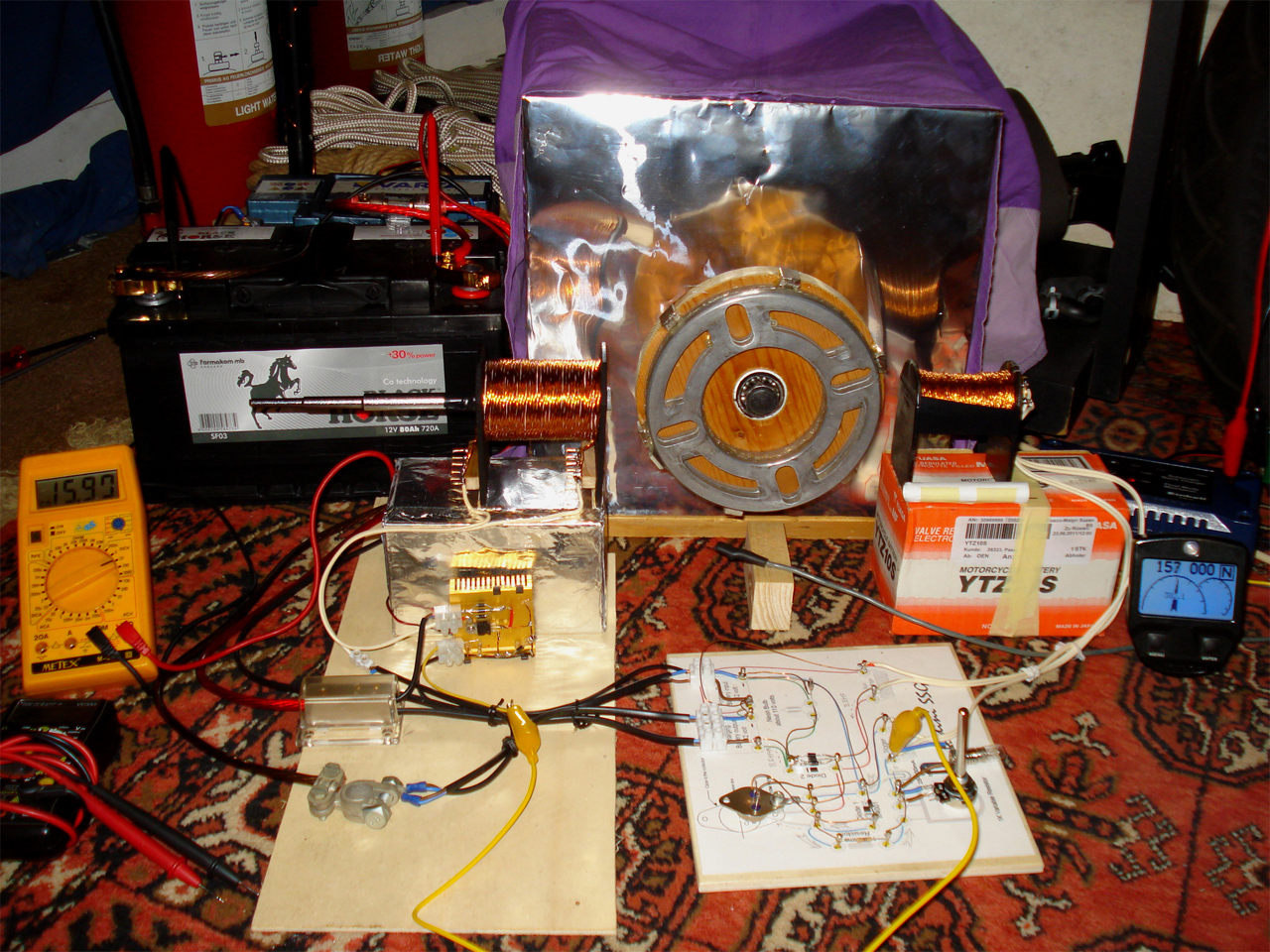

Time for version 3, the first small wood/alu rotor again but even heavier as contrast. About 1/4 heavier the ver.1. Meanwhile i attached my second coil i built because of the impedance (?) problem of my car batteries. So heavy, small wheel and two coils, two circuits.

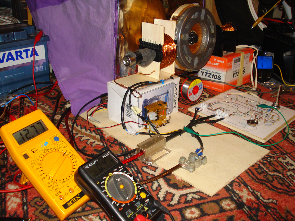

The starting 3055 and a new BD243 circuit, triggered by the SG.

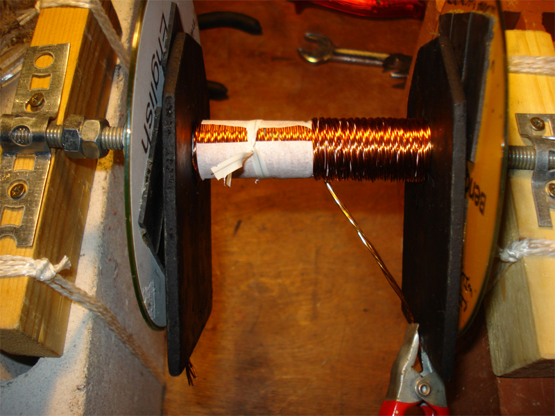

The BD243 coil is a five filar twisted #22 wire, 456 turns, 2,9 Ohm, lacking a state of the art core right now. Only one wire connected till now. This is the actual setup.
Further improved: multiple diodes and thick cable to charging battery, soldered the lamp in and trying to understand the correlations between resistance, impedance, draw and rpm... hmm
All runs compared to starting point real smooth, quiet, fast and reliable. It only stands still when i work on it. Charging seems better now, but i have to see first the bat in charge. I used the time i had until i finished the second coil to test some AA 1800 und 2300 mA accus. They were dead. I charged them in the Bedini while upgrading, put them in a small light and could draw 1620 mA after one charge. I was astonished... but have first to repeat it a few times.
