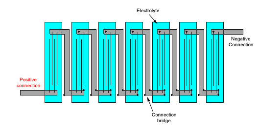

        Hi Jetijs,
        To confirm the foam develops because of cold electrolyte, do the followings.
        1. Run the electrolyser for about 30 minutes or more until electrolyte gets warm and no foam develops.
        2. Now, drop a little bit of distil water into one of the cell and see if foam develops in that particular cell.
        3. Or to make things easier, blow some cold air on surface of cell. See the changes to white gas foam.
        If you use neutral plates, then you should not seperate the plates with cell divider. You made series cell. See the attached picture. I believe your design is similar to picture attached.

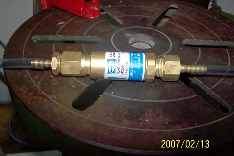

              • #52
                Hi Aaron,
                I have attached the commercial flashback arrestor which I used on yesterdays testing. I got this item free from my friend so I don't really know the price (should be very expensive).
