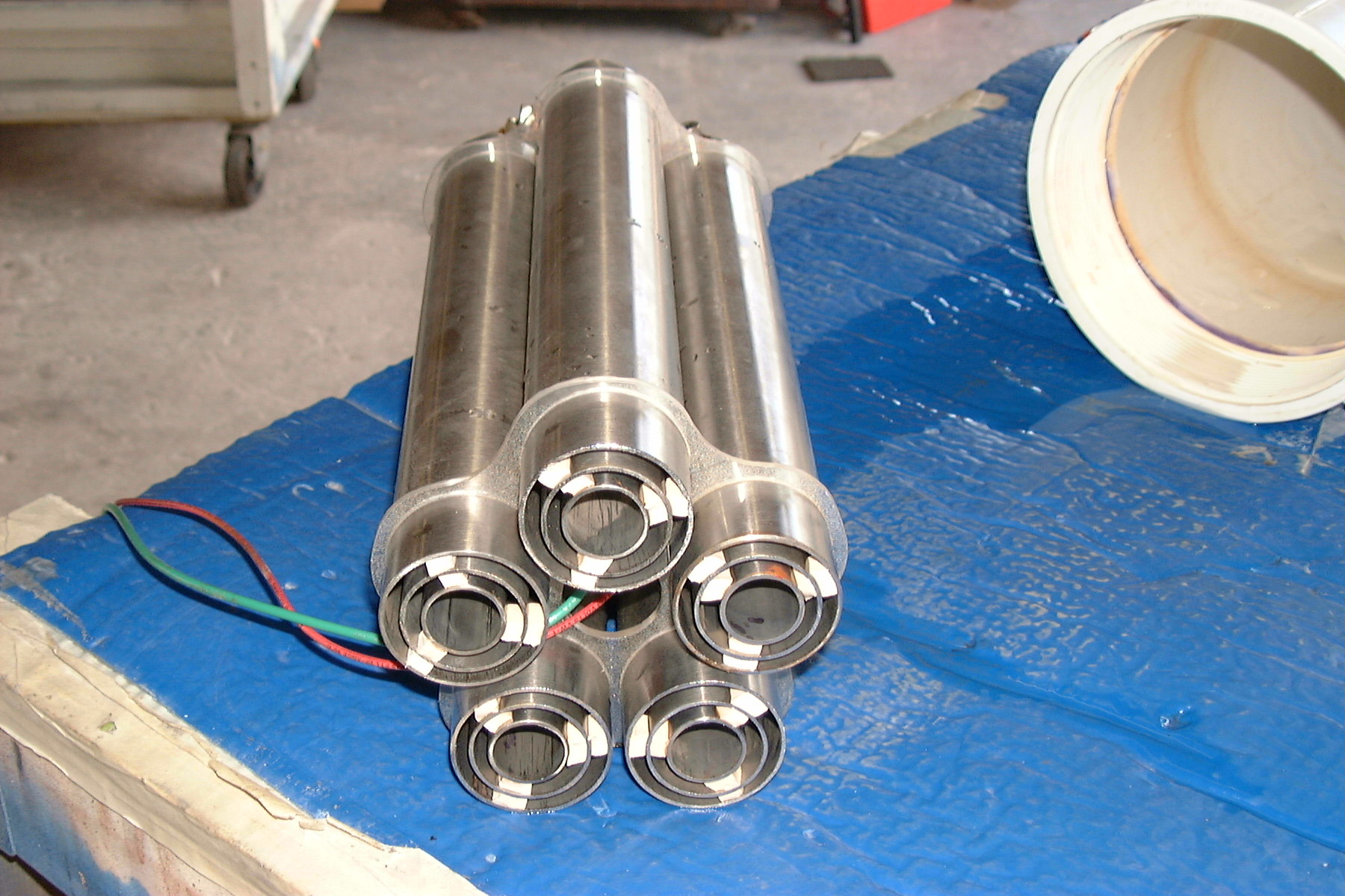

          Not yet on the annealing process, these are just test cells, still trying to figure which configuration to use of cell design. I made another cell, pics attached, still like my original "five shooter" open bath, but this time with a nuetral tube in between anode and cathode (all separated with natural rubber). Makes alot more gas than it did without the nuetral, still have to condition and fine tune of course. I observed gas bubbles generating from ALL surfaces except the outside of the outtermost tube (+positive). Just to see what would happen, I added enough KOH to pull about 14 amps and produced 1 liter of gas in 1 min. 15 sec., not bad for a non-conditioned cell only one day old......looks promising at least! I will, of course, be using a PWM and NOT brute force, just wanted to see.......I need to hook up with Redmeanie soon for some electronics. My spacing between the tubes is too far apart for the moment, but I'm fixing that tomorrow with another mod to my configuration. I will post more pics after I assemble the next design. Thank you, to everyone who posts info on this forum..............PRICELESS!!

            The cell looks great. I am building a cell like that. I am just waiting for the SS tube's to show up. Have you tried them in series? and what spacing are you going to use?

              I actually hooked it up series last night, with wonderful results! I first tried - + -, figuring that since the hydro molecules are attracted to negative, I should get good gas by having two neg tubes. HOWEVER.....when I hooked it up + - +, I got WAY more gas production (on same 4 amp draw) , don't make sense to me.......but neither does paying over $4 a gallon for gas! .......so it works however it works!! To recap my progress..............
              pics posted of both cells earlier in thread
              First cell was "five shooter", using 1.5 in. inner tube and 2 in. outer tube
              inner 1.5 in. tube negative--------outer 2 in. tube positive
              Produced gas, but not impressive (although tubes were not conditioned)
              Second cell was "five shooter", using 1 in. inner tube, 1.5 in. middle tube, and then 2 in. outer tube
              inner 1 in. tube negative, middle 1.5 in. tube nuetral, outer 2 in. tube positive
              Greatly increased gas production, thought I might be on to something.
              Hooked up last night in the fashion described above and visual analogy was about twice any production I've accomplished to this point!
              NOW.....seeing as how my tube spacing is at 1/4 inch (minus the thickness of a tube wall), I feel I need to close the gaps to 1/8 inch or less. I have SS tubing coming in today in diameter of 1.25 in. and 1.75 in. These tubes will slide in between the 1 in. and 1.5 in. tubes and also in between the 1.5 in. and 2 in. tubes. Runing these two new tubes as nuetral will decrease my amp draw and at the same time increase gas production (as demonstrated to me above). The spacing needed to be closer together anyway to obtain better production. I will post new pics as soon as I get the new tubes added. I have a digital camera that will shoot video, just no sound. I will probably need some advice from someone on how to get the videos uploaded, haven't had much luck with that in the past. Thanks again to everyone for helping out with advice and ideas, this is turning into an awesome venture!

                  Hi Jstadwater,
                  What's the news on your cell above? How is it performing with the neutral tube? Also curious to know what voltage drop you are seeing across each cell....
                  Definetly looks interesting...
