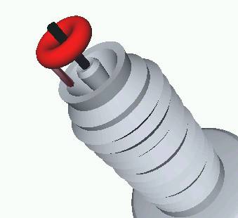

Uncle Fester, I can answer #3 about the plugs . The plugs consist of a Champion resister plug with the resister removed , the ball is tig welded nickel ( no alloy ) turned on the lathe. The cage is nickel tig rod ( no alloy ) flattened and bent over a mandrel then tig welded to the plug body.
