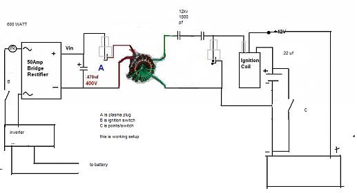

        • Hi revizal,
          How did you wire Tero's circuit to motobike? Did you connect positive voltage to chassis of bike? I'm afraid of an electric shock.
          If everything is clear. I'll test on my bike too. Its exhaust make a lot of black smoke now.
          Thank you.

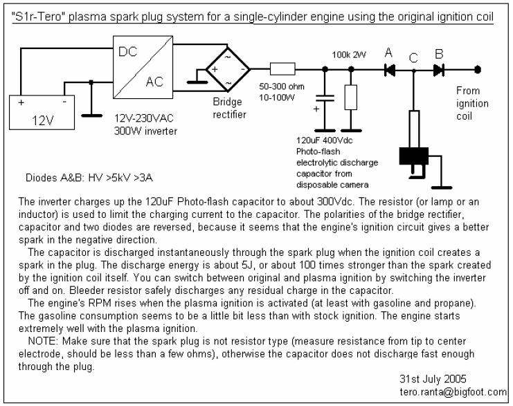

              Firstable, I tried to ground the (-) of cap to the engine block, but it did work. I decided to follow S1R-Tero circuit with (+) of cap to grounded and as you see it worked.
              I think the right side and left side of circuit separate each other. As long as we could discharge the cap effeciently it doesnot matter to the original engine's circuit. No electrical shock on the motorcycle. Feel free to apply it on your motorbike.
              Rev.

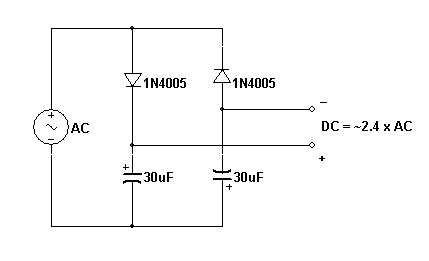

                              Hi Greg,
                              excellent work You can use the circuit attached below to double your 120v voltage. I have noticed the effect is better with higher voltage that capacitance.
                              Thanks for sharing.
                              Luc

                                Hi Luc,
                                Thanks for the schematic. I will build one and test it. I really want to up the voltage. I guess now's as good a time as any. I probably can drop the capacitance also.
                                Peace,
