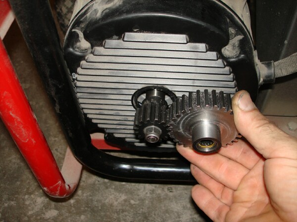

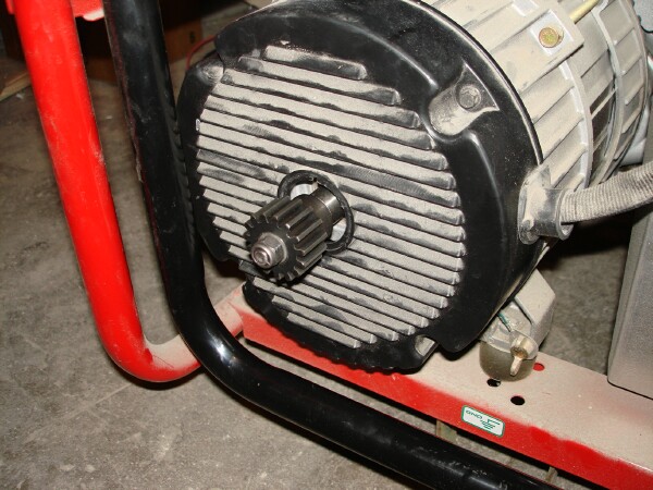

Hi Luc,
Thanks for the update. I will most likely put a 2:1 fiber gear setup on the rear of my genset. Mechanical things are quick for me. I have a machine shop as part of my business. I can likely make a plate, mount the gears, reed switches and magnet rotor in a day's time. Finding that day is an entirely separate issue. Most will appreciate that.
Peace,
Greg

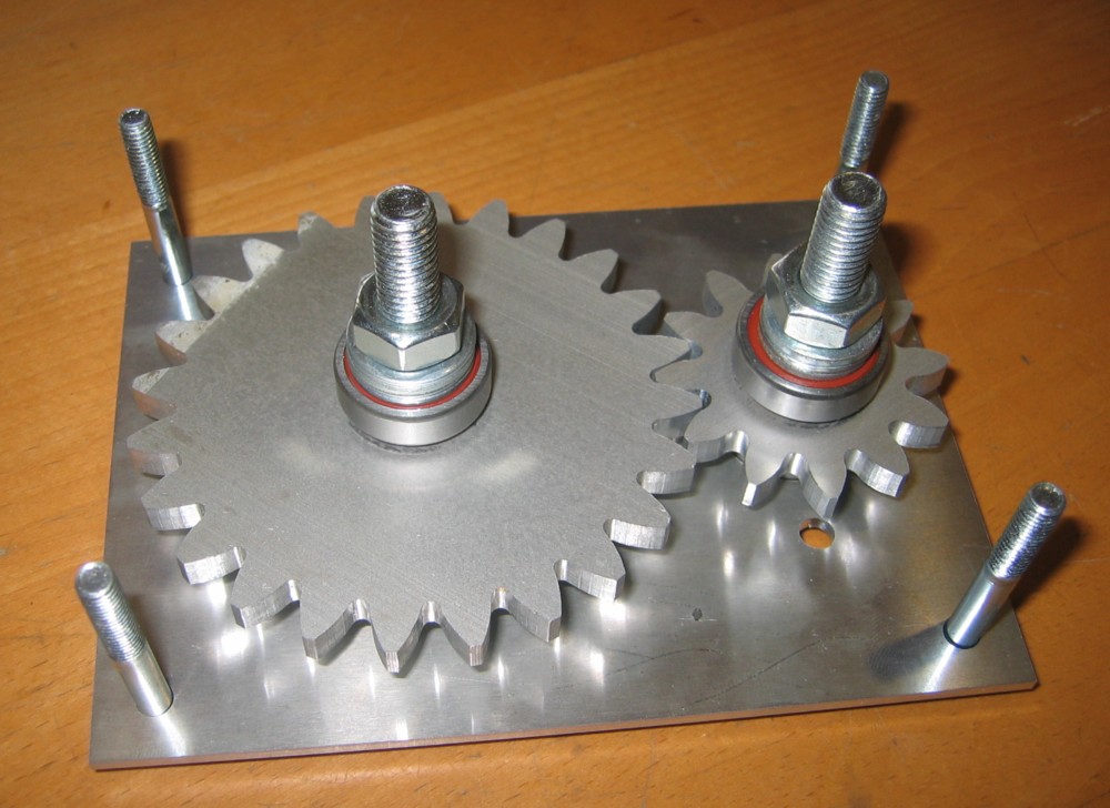

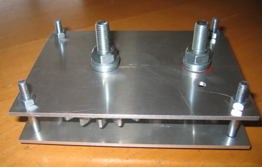

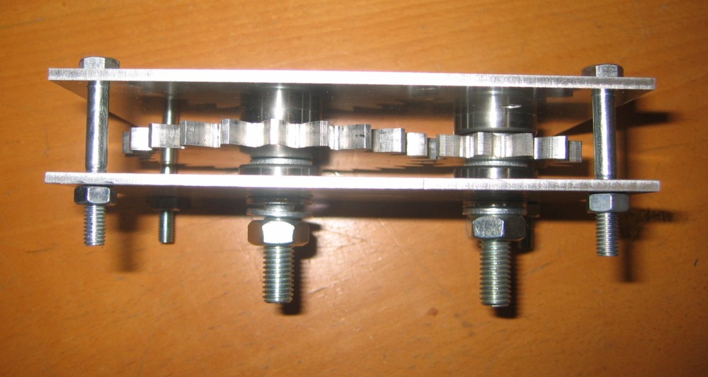

... no obstacles for you
