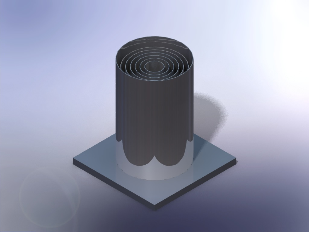

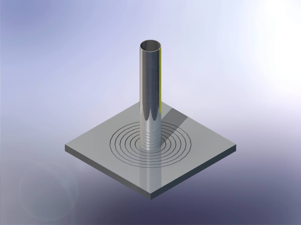

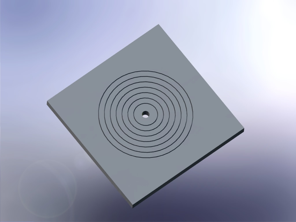

        Cell Renderings
        Hi ash
        I started out with a few basic renderings in Solid Works, just chechking if im on the right track. I had to make a few improvisations as far as some measurements are concerned but heres what im starting with...

          Man that looks perfect as it is simple. I know all the measurements for the center Rod and cylinder are in the document, but its just not spelled out for newbee friendly (myself) I know Lee would be able to tell
          Looks perfect, i think its a matter now of just putting in the cylinder sizes , lee what do you think?
          ""To summarize, the unit is a 6 cell unit using 7 tubes (diameters 4" / 3.5" / 3" / 2.5" / 2" / 1.5" / 1") The outer tube is connected to negative and the centre tube is connected to positive. The centre 1" tube is connected to a 8mm (5/16") stainless steel threaded rod with a 1 inch s/steel washer so that the rod provide an easy and secure outside connection to positive.
          The outer tube will be slightly longer than the inner tubes which are all the same length"""
          The improvement would be the water level indicator Praveen did this already, i think its going to be the best compromise between a plate cell and a Smacks for reliability, bang for your buck and compact size.
