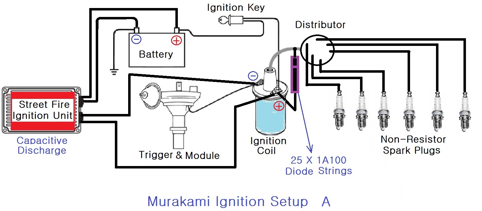

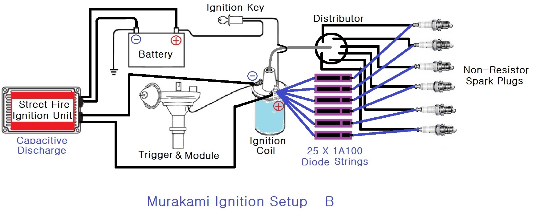

      Which ways is correct hook up method ? A or B ?
      Hello !
      This post for Mr. Aaron.
      I read your book "The Ignition Secrets".
      After I read your book, I try to install the plasma setup to my car.
      But I have a question regarding the diode string hook up method.
      I upload two kind hook up diagram that A and B.
      A has only one diode string for plasma ignition and
      B is hook up the diode string each spark plugs.
      Please help me right method.
      Thank you.
      Luis

        Hi Luis,
        There could be many more reasons to rather use your proposed "B" setup, but to mention only a few:
        1) For a 1 cylinder engine your "A" diode hookup will work because it only have to produce 1 plasma burst every 2 crankshaft rotations. But you have a 4 cylinder engine, with 3 more plasma bursts punches on your coil & diodes every 2 crankshaft rotations, which could damaged an "A" setup string quicker. So use your proposed "B" setup, and each diode string will only get a plasma energy punch for 1 cylinder at a time, and last much longer.
        2) In your normal engine, each of your spark plug wires have a metallic contact in your distributor, and when the distributor rotor touch it, the high voltage (HV) goes from your coil to one spark plug - but there is a minute gap between rotor and contact, and a spark jumps over it as the HV flows from coil to spark plug. If you used your proposed "A" diode hookup, you have a HUGE energy jumping between your rotor and distributor contact, which will most probably damage your rotor and contacts very soon. But if you use your proposed "B" diode hookup, then your distributor rotor and contacts are spared.
        I'm sure there might be more reasons why you should rather use setup "B", but for instance, when I was teaching myself on a little demo how to doe the hookups (like "A") that HUGE extra energy blew my capacitor. I had that plasma spark on my (1) manual trigger switch, (2) diode-coil connection, (3) and over the spark plug gap. As any current, it flows wherever you give it a conduit path, and jumps any little opening or bad connection, "eating" the material.
        Am not saying that this energy will blow your MSD - no, not at all, otherwise everybody would have stopped using them - but all your equipment will work and last the longest if you use your "B" proposed hookup.

            (1) Yes, you can reduce the number of diodes, as long as the replacement does NOT give less protection and performance that your diode string. The idea of the diode/s is to make the HV want to jump to a lower resistance (diode string) than the high resistance of the spark plug gap. The 6A100 diodes are specifically advised by Aaron and many others that used them because if you have enough of them, they will withstand the HV / RE punch and help deliver that discharge to the spark plug effectively and effenciently. You can rather use more diodes than you need, than not enough of them (in this case more is better than less). So, if you use another diode/s that can directly replace the total spec of your diode string to reduce the number of components, it should be fine. Lately the trend was to replace a diodes string with one 30 KV 2A Ham Radio Diode Block, which is about 6 inches long. So 4 of these blocks, 1 per spark plugs would work. Quite a number of people starting using them and found them working quit ok.
