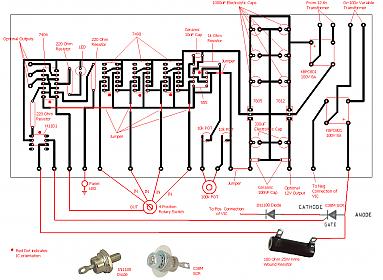

        8XA Circuit
        Originally posted by thedude View Post
        I do try to understand Meyers circuit. One of the problems is that I have seen at least 10 different interpretations of it in schematic form and i'm really not sure which is most authentic anymore. Speaking of which. Is there a link to H2opowers current schematic design? Joe, do you know the name of H2opowers other thread here?
        h2opower is using this 8XA circuit from Tony Woodside's site.
        Tim
        Warning the schematic is wrong! The connections to the H11D1 are reversed. The resistor connected to pin 4 on the H11D1 should be changed to pin 5 which is the input. Pin 5 connection switched to pin 4.

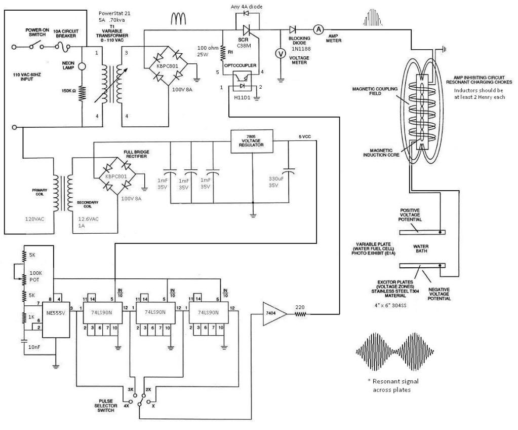

              Here is a 8XA circuit modified by H2opower (I believe) that no longer needs the adapted alternator as a power source, it will now run straight off a battery
              This is the one I guess in the youtube clip
              • #22
                        [ATTACH]8531[/ATTACH]
                        In the attachment, what is the wave form? well it is a carrier with an AM modulation, one frequency with another lower as modulation.
                        I have seen most of Stans work first hand with my own eyes, I know what is the truth to how he did it, I saw it in a couple of hours of seeing his circuits for real, though it only confirmed what I new before.
                        Another thing is a lot of his work was copied from others and manipulated to seem it was all his doing, sorry but what H2Opower is doing is a waste of time and money. You may as well use a Faraday cell and change the gas afterwards, the changing of the gas IS THE KEY and nothing else.
                        By the way the injectors NEVER WORKED, they could, but there is a design fault, the system is so simple you would kick yourself. You would be better off looking at the system of plasma ignition but that alone is not the complete process but comes close.
                        The whole process takes place from start of process to finish of combustion in MICRO SECOUNDS when a system of injector plugs is used.
