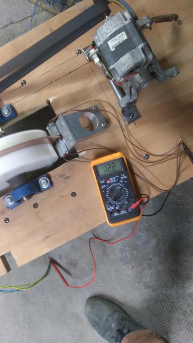

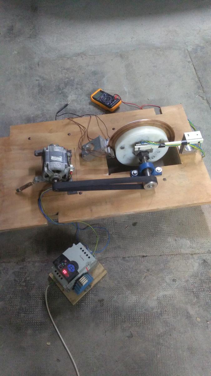

                        I tried to replicate Bruce De Palma's homopolar generator, I used a copper disk with a diameter of 33cm, and 6 cylindrical 52n rare earth magnets measuring 6cm x 3cm, mounted in pairs on both sides of the disc and inserted in those nylons plates that you see in the photos to keep them united and integral with the disc of rotating copper, I turned it into rotation at 2800 rpm, I used 4 carbon brushes on the 2 inch diameter copper shaft and 4 brushes on the periphery of the disc, but the result was very disappointing, as you can see from the photos , not only the very low voltage, but the serious thing is that the amps were almost non-existent, we are talking about 0.2-0.3 amps ..... why? does anyone have an opinion about it or should I conclude that it is another fake ....?

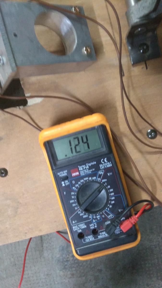

                          these are the measures of the volts, are 0,12V

                            Here's a possible reason for low output. The net flux through the copper disc is near zero. Magnetic fields are conservative, meaning the flux from the North pole is equal and opposite that of the South pole. Flux lines are loops passing through the magnet. So the flux going through the disc in one direction is cancelled by returning flux cutting the disc in the opposite direction. You need to provide a return path, or complete the magnetic circuit outside the disc diameter. This is called back iron. In this case it needs not be laminated because the flux won't be changing. But it does need to be ferrous.
                            Also reduce resistance in the output (electric) circuit. I'd suggest to use copper brushes, at least for starters. Maybe repurpose battery contacts from a flashlight. Then later on find some high copper content motor brushes.
