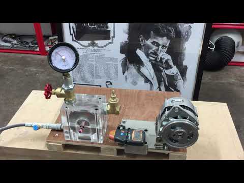

  • Our Mk2 Tesla Turbine 5" Stainless Steel 316 Rotor Warps at 682MPH and slows turbine down by rubbing on the acrylic casing.
    I could smell it whilst I was watching through a blast shield! As it slows down the metal changes shape and allows it to speed up again until the pressure has decreased too much in the compressed air tank to allow acceleration.
    The stainless steel 316 metal has not got a high enough yield and tensile strength for these pressures and speeds. This is also why Tesla recommended tapered discs. You can not taper stainless steel 316 easily. Forged discs would work well.
    This is probably the fastest Tesla turbine since Nikola Tesla was alive. How did he do it? He used Nickel Silver which was the highest yield and tensile strength metal available at the time aka "German Silver", C770. Nikola Tesla also invented analogue dynamic balancing which is far superior to digital or static analogue or digital balancing. British Patent 186,799
    To allow the rotor to supersonic speeds we will now use our hardened stainless 420HTP (surgical steel) rotor with tapered discs which is the full Mk2 design. Also we will use our simple design stainless steel 316 air bearings will enable:
    1. Quiet running
    2. Supersonic starting speed which will enable:
    3. Continuous vacuum with no compressed air input - Self-Acting Machine
    4. Ambient air tap for port (one that tap fell off) to turn machine into self running adjustable speed motor
    5. Ambient air tap for diverging nozzle for rapidly converting atmospheric pressure and heat to distilled water. Dehumidifier on steroids!!! I need to get the new rotor balanced and retest to show you the difference.
    I expect it to be far superior in all the ways I have described.

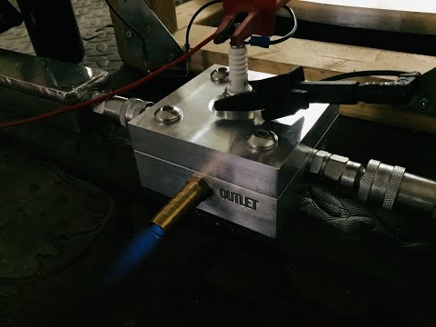

      • For the last month I have been building Nikola Tesla Pulse Detonation Engine (PDE) in an effort to replicate Nikola Tesla's Fig 1, 2 & 4 from the Valvular Conduit patent.
        US Patent 1,329,559
        https://teslauniverse.com/nikola-tes...lvular-conduit
        The purpose of this device has not been fully realised yet but it is my mission to enable that to happen.
        The purpose of Tesla's PDE is to boil water. Tesla was quite secretive about this fact but if you had studied Tesla and his electrical and mechanical work to the depth I have, it would become very obvious.
        Tesla writes in the Valvular Conduit patent:
        "To prevent injury through excessive heating a jacket 25 may be used, or else water injected, and when these means are objectionable recourse may be had to air cooling, this all the more readily as very high temperatures are practicable."
        Here is an extract of a Nikola Tesla article from 1916 called "Wonders of the Future".
        If you've never read it buckle up! https://teslauniverse.com/nikola-tes...2WJ0MYrNVeaD5E
        Here is an extract:
        "Water power offers great opportunities for novel electrical applications, particularly in the department of electrochemistry. The harnessing of waterfalls is the most economical method known for drawing energy from the sun. This is due to the fact that both water and electricity are incompressible."
        Here Nikola Tesla show how to use gasoline gravity fed into the system.
        Notice how he doesn't show a water supply to or from the water jacket???
        Tesla is a master teacher as he manages to encapsulate his teachings deep within his work. His intentions hidden from the financial elite and copycats left for someone in the future to come and point the way!
        Here are my progress videos.
        Here I show the difference between "Capacitive Discharge Ignition" & "Aaron Murakami's Plasma Ignition"
        After some basic modifications by opening the ports up to 7mm I show the first time I got the PDE into self resonance.
        Tesla states in the Valvular Conduit patent:
        "After a short lapse of time the chamber becomes heated to such a degree that the ignition device may be shut off without disturbing the established regime."

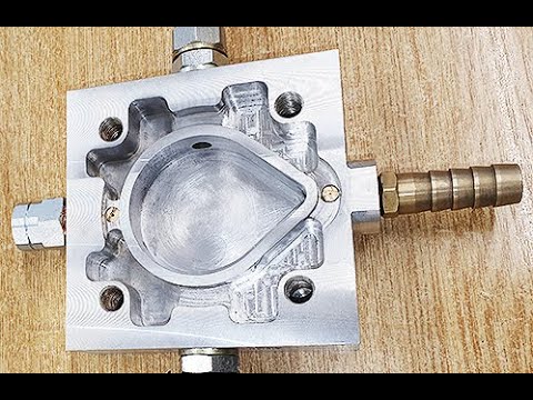

        • Here are the modifications I propose to turn the self resonating PDE into a steam boiler.
          The rapidly expanding steam will siphon a water tank.
          Steam at 100 degrees C / 212 degrees F has a density 1,700 times higher than the volume of water, therefore a 1 gallon tank of water can in theory produce 1,700 gallons of steam.
          The rapidly expanding steam is capable of moving at supersonic speeds. This expansion can cause a venturi vacuum which will lower the boiling point of water.
          Steam at 17.5 degree C / 63.5 degrees F has a density 67,000 times higher than the volume of water, therefore a 1 gallon tank of water can in theory produce 67,000 gallons of steam.
          As the steam gets colder the density goes up. I cannot find a table that goes any lower.
          My understanding of Tesla's PDE is that the system is an open air "Cryophorus".

                • It just struck me today that by adding the Tesla turbine converts the Pulse Detonation Engine into a Rotating Detonation Engine !!!
                  Also as the Tesla turbine has an equal and opposite reaction to the flow going through the rotor, it also pumps air into the exhaust with pushes back on the Tesla valves.
                  I've literally just been sent this by my machinist.
                  Testing will begin soon!
                  Tesla state in US Patent 1,329,559 Valvular Conduit
                  "Upon the subsidence of the explosion the pressure in the chamber sinks below the atmosphere owing to the pumping action of the rotor or ventilator and new air and gas is permitted to enter, cleaning the cavity and channels and making up a fresh mixture which is detonated as before, and so on, the successive impulses of the working fluid producing an almost continuous rotary effort."

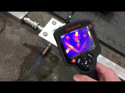

                  • I had the combustion chamber modified to the drawings above. I did two tests, the first one with "gravity" fed water and the chamber flooded instantly. The second test was with a water injection nozzle and pump. This worked and made steam without putting out the detonations.
                    However I wasn't satisfied with the results and went back to the drawing board.
                    This is the design I came up with with carburettor style jets.
                    An inlet water jet and an outlet water jet and the combustion chamber sealed apart from the water jet inlet and outlet.
                    I started off with a 0.5mm inlet jet and 0.5mm outlet jet.
                    To my astonishment it worked first time with the chambers temperature rising rapidly whilst gravity fed water turned into super heated steam.
                    Luckily I had a camera and filmed the event for everyone to see what happened.
                    Next I will try a 1mm inlet and outlet to compare the difference.
                    The current exhaust is jet an off the shelf brass 1/4" BSP 10mm straight port, with the exhaust throat 7mm.
                    The chamber is one half of a De Laval nozzle and now I'm working on the rocket exhaust to turn the heat into velocity and partial vacuum.
                    The rocket exhaust has the capability to turn the hot gases into supersonic / hypersonic flow which is to impart its energy to the Tesla turbine via viscosity and impulse as it hits the star washers as the gas exhausts.

                              • Turbine.jpg This is the kind of casing I'd like designed for a turbine.
