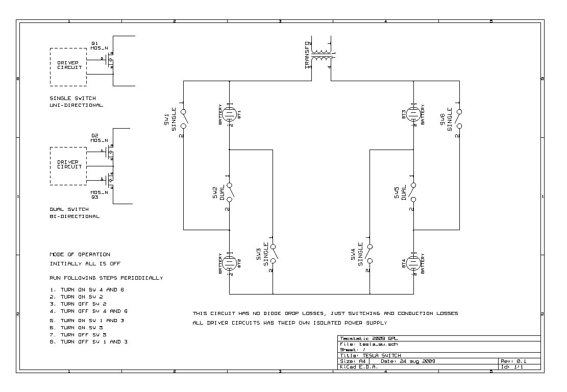

                        A bit more information.
                        I have a "separate" switch mode power supply, which generates 0-3-15V for each separate driver circuit.
                        These supplies are insulated from each other, up to several thousand volts.
                        The controller generating the timing signals is going to be a micro controller.
                        The ISO721M ICs are transferring the timing pulses like an ordinary opto-coupler, it is just much faster, up to 75MHz and isolating 4000V peak, 560 V sustained working voltage.
                        So the gate voltage will always be in accordance with the ucontroller control timing signals, as long as the MOSFET source pin is operating within the 560 volts from uController ground sustained, or max 4000V for seldom occasions.
                        I got confused so I did a draw of the needed circuit as I see it.
                        @all
                        I have now attempted to be constructive, now the rest of you has to see if you can find any flaws. Please examine the attachment.
                        Here I have avoided all the driver circuits. They are known well functional circuits, so to make it much more readable I just consider the MOSFETs as switches.
                        Eric

                          • Yet another sequence
                            If we think of Bedinis statement, that a small amount of current is necessary to keep the batteries in charging mode, radient alone does not do the job, then this sequence might be better.
                            1. Turn on SW2
                            2. Turn on SW4 and SW6 simultaneously
                            3. Turn off SW2 (dual switch)
                            4. Turn off SW4 and SW6 simultaneously
                            5. Turn on SW5
                            6. Turn on SW1 and SW3 simultaneously
                            7. Turn off SW5 (dual switch)
                            8. Turn off SW1 and SW3 simultaneously
                            With this timing a battery "sees" this sequence:
                            1. Current draw when in serial
                            2. Radiant "spike" when the dual switch is opened and the internal MOSFET diodes of the "single switches" starts conducting.
                            3. Current charge in parallel, to "slam tight" the "fluffy surface charge" from the radient event.
                            I expect this charging effect to be strongest, if we just connect an inductor or a DC motor (and bridge).
                            The effect is probably weaker with a transformer, depending on the coupling factor of the coils and the magnetic circuit properties.
                            I have to try this in the near future.
                            Any comments ?
                            Eric

                              I haven't done a full comparison of your switching but you seem to have the general idea. connect the neg between banks and run from the Pos side and you only need 6 fets if they are wired and switched right.
                              I tried the "Double" fet switch as it is the By the book way to do it there , but in real world it does not work , I don't remember what the deal was with it as it was about 3 years ago when I tried that method.

                              The main thing is to make sure that the series connection is made before the parallel so that the Higher potential always flows as desired
                              • Originally posted by Tecstatic View Post
                                1. Turn on SW2
                                5. Turn on SW5
                                Any comments ?
                                Eric
