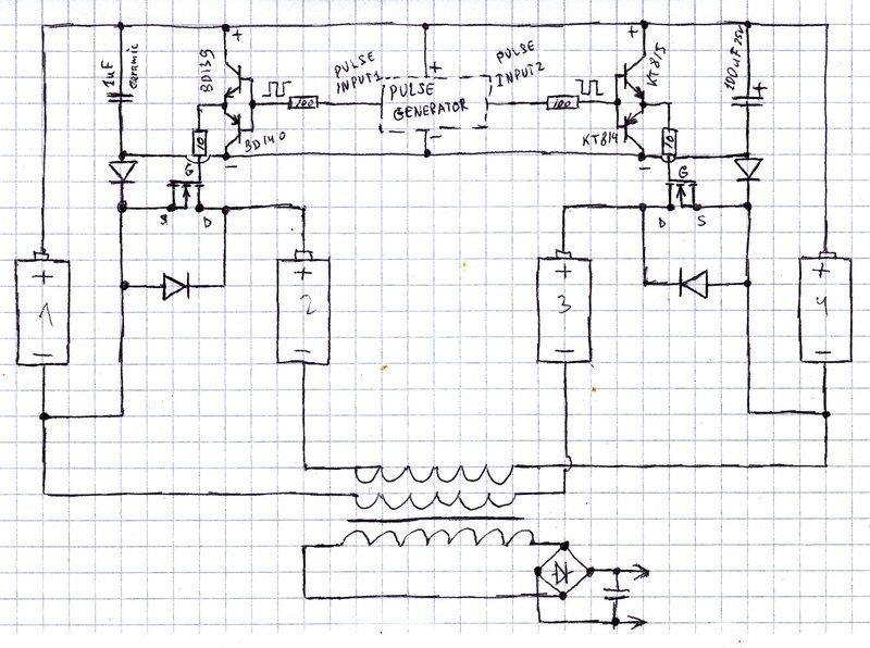

Hi Garry,
I see Matt hasn't answered your question about the diodes yet so I guess he is busy or out of town again. Those diodes appear to be there to supply a negative connection for the controller back to whichever battery has the highest voltage. I think you can use almost any diode as long as it has a voltage rating of 50 volts or higher and a current rating of a half amp or higher. Matt will correct me if that is not right but I am pretty sure you will be safe with what I have said. I built mine using the opto coupler circuit so I didn't need those diodes. Good luck on your build.
Carroll
