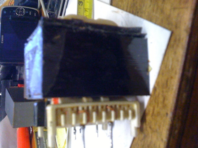

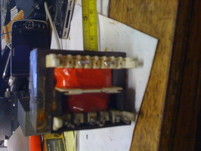

Hi guys,
Not being happy with the results from the OFF THE SHELF 12-0-12/240v
transformer, I want to pull apart an old centre tap that is 2.25" x 1.75" x
1.5". This old transformer was kept out of a ghetto-blaster type cd/tape/radio. The primary is open circuit.
I would dearly love some advice on how to pull this apart so I may rewire
using Matt's wiring scheme.
Has anyone got any tips on how to best pull these apart without destroying
the laminations
and
as the windings appear in two segments, when we rewind, do we try and use
the entire spool or just stick to one half.
Thanks, Garry
I'll try and pop a pic up soon.Last edited by garrypm; 10-09-2011, 04:05 AM.
Hi folks, Hi garry, when I took apart my transformer, I removed all the wire first, then used a small flat head screw driver and lightly tapped in proper spot on edge of lamination as the first lamination seems the hardest to get off, then the rest pop off more easily.
An exacto knife is useful also to encourage any stubborn laminations to separate.
Though mine had no rust and was not weathered, so maybe yours could be more difficult. Hope that helps.
