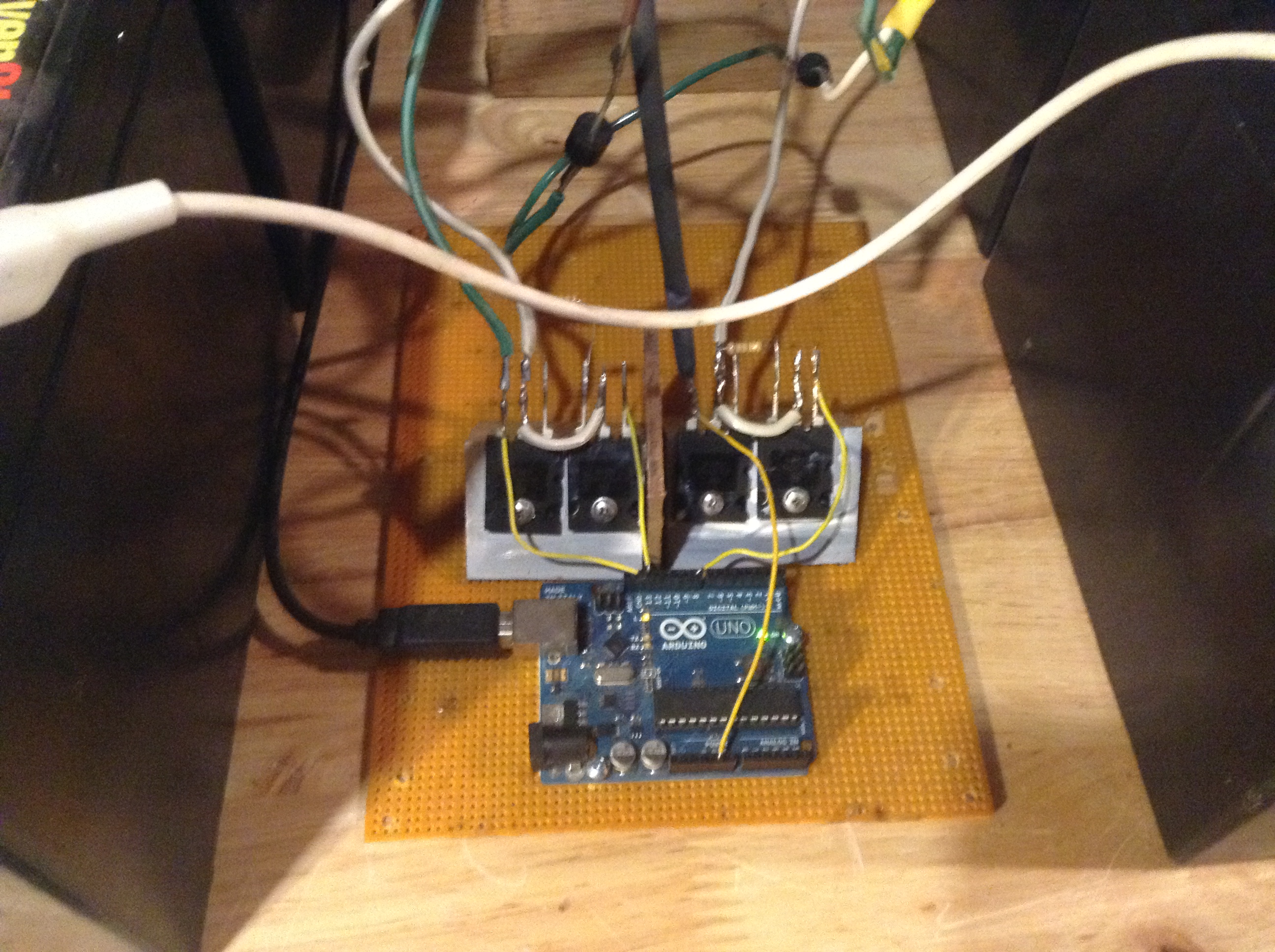

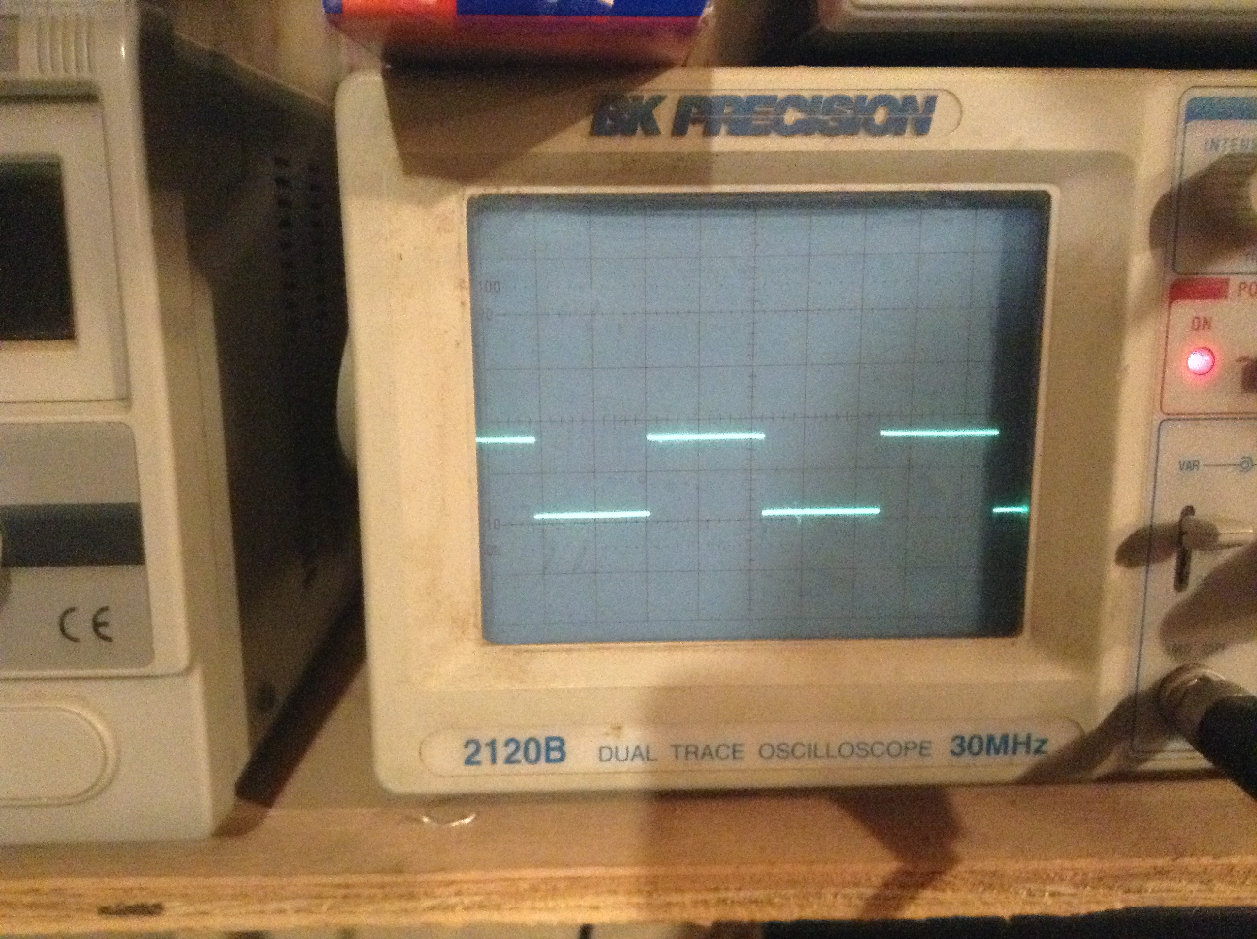

          • 2 pics
            Hi All,
            two pics.
            One is the beautiful square wave that Matt's circuit produces with arduino.
            Two is pic of circuit while running.
            Thanks bro
            [ATTACH]14632[/AT[ATTACH]
