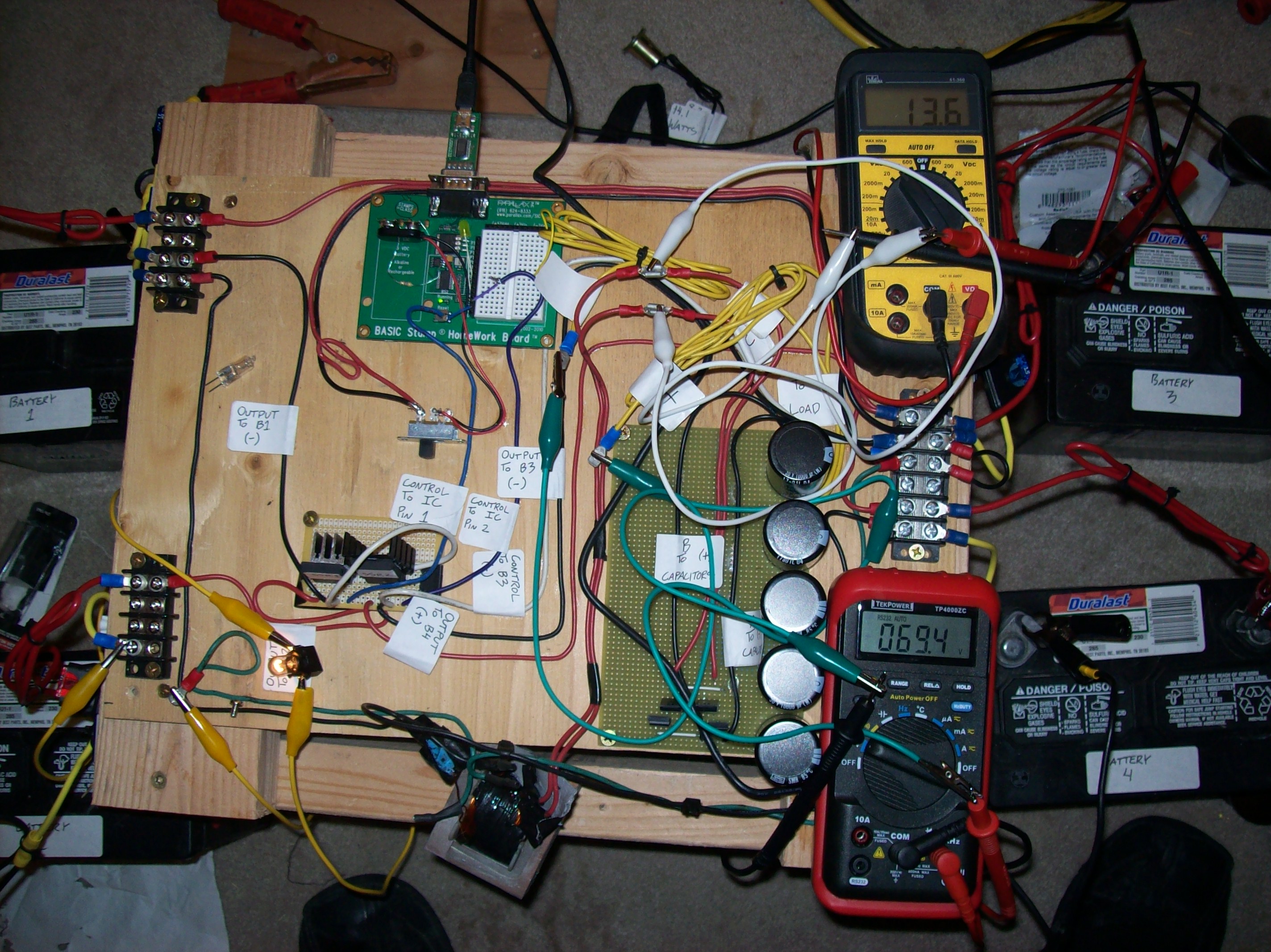

I'm using two battery sets - 4x 1.3 A-h 12V SLA and 4x 4 A-h 12V flooded lead-acid for scooters.
Transformer is like Matt recommended, originally ~30W, rewired with ~90 turns each of primary and ~110 turns of secondary 20AWG.
Loads 6W bulb or 21W bulb.
Now I continue tests for different conditions and combinations.
Looks like I found something, need to repeat for confirm.
