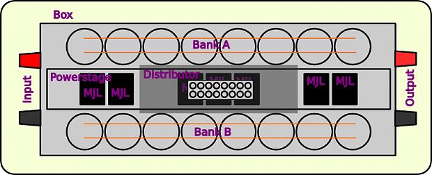

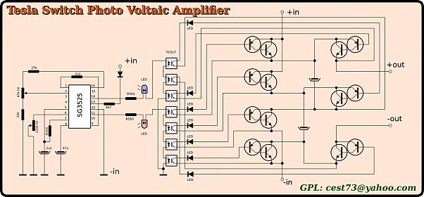

I do have a "kind of" TS PV Amp
1. It's unofficial
2. It's officially unsupported
3. my work is GPL, but I hereby ask JB's permission before going public.
4. private copies are permissible under non disclosure conditions only (free of charge)
Schematics I used are my own brainfart, but are strongly biased with what JB thought us here.
No guarantee, not fitness for particular application, (GPL "blah, blah"...)
Use at own risk, don't dare blame me etc...
anyone still reading?

Just a great job. Good work.

Each and every one is 10'000 uF @20V (=cheap) or 50V (initial testing)
So it's
80'000uF each bank
40'000uF @40V in series (to battery)
160'000uF @20V in parallel (from PV or PSU)
AND
they fill up to 18V not higher (ever)
And they dump to 55% "SoC" of the receiving battery, not lower (about 8V) (ever)
AND
usually they swing 10...12V back and forth (yep, 2V only)
Stevan C.
