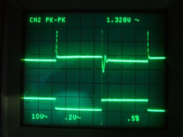

I was able to pull some more power from the battery with the headlight for a about 10 seconds and ran it down to 4.2v.
I decided to increase the voltage (drive current) to the optos, since the nice spike was gone. Attached is the scope shot I'll let run today. First 30 minutes have brought it back to 4.44V.
Notice how thin the spike is when then SCR is fired? It goes up and down the screen through the opto signals. (I didn't get a picture with only the A-K shots.)
Remember how John says we don't want to let the current flow? I now understand this means fast ON and fast OFF with virtually NO time between the two.

I was able to pull some more power from the battery with the headlight for a about 10 seconds and ran it down to 4.2v.I decided to increase the voltage (drive current) to the optos, since the nice spike was gone. Attached is the scope shot I'll let run today. First 30 minutes have brought it back to 4.44V.
