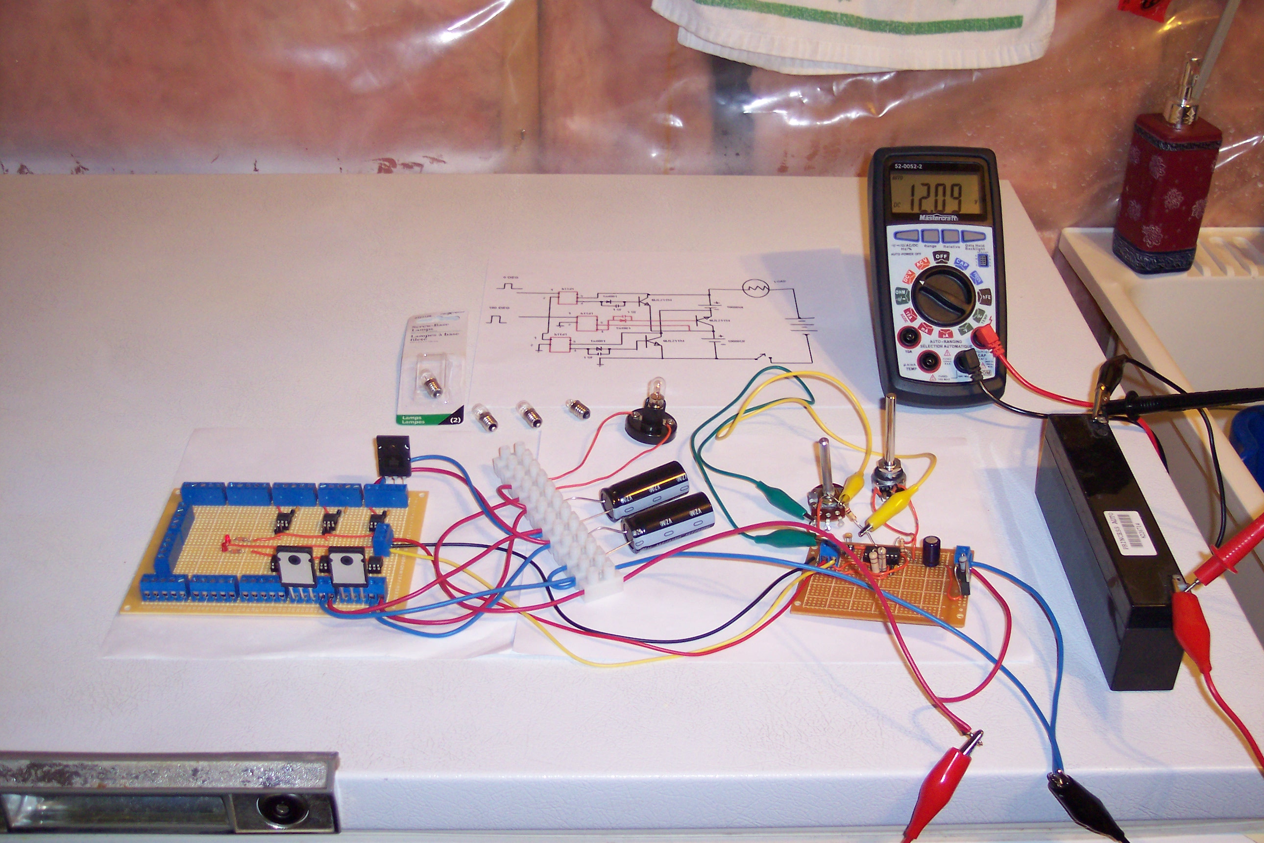

            I got my circuit finished today and started testing
            Specs:
            2.6 ah valve regulated 12v lead acid battery
            load is #47 bulb
            2 x 10000uf caps
            3 x MJL21194 transistors driven by H11D1 optos with 1n4001 and 1uf cap in parallel driven by SG3524 circuit
            Battery start resting voltage 12.18v
            Running about 8hz with less than 50% duty cycle
            (have not hooked up scope to it yet to get exact measurements)
            Noticed bulb pulses brighter on parallel charging part of cycle.
            Bulb is dimly lit.
            Battery bouncing between 12.09 and 12.10V for the last hour.
            Will let it run and see what happens.

              Real nice to see that you working Alex.

                Hi Alex
                Nice to see someone else also trying the scaler charger
                I noticed that you supply the sg chip from your battery. It looks like you use a regulator, diode and resistor there?

                          • Originally posted by nvisser View Post
                            Hi Alex
                            Vissie
                            Hi Vissie,
                            Yes, you are right. I have a 100 ohm resistor, 13v zener and 10v regulator and a 220uf cap on the output of the vreg. I did this to limit the supply voltage in case I used a DC source greater than a 12v battery. The 13v zener is an effort to protect the voltage regulator which will heat up too much if input gets too high. I may put a higher value zener there or multiple 13v in series in case it is chopping off the spike meant for the battery. It is also an effort to protect the IC and keep its output stable. I built the SG3524 circuit to be a multi-purpose setup that could be used for more than just the task at hand. It has a socket to hold up to two timing capacitors for different frequency ranges and I used higher value pots for varying the frequency(1MOhm) and duty cycle(500kohm). You can see in the picture in my last post that I have the 100k and 200k resistors bypassed with test clips for more variable frequency adjustment for this test setup. So I should be able to use this sg3524 circuit variant for the scalar charger or the 4 battery switch or even possibly a "dielectric emf recycler" or anything else that would need 1 or 2 channels of pwm driven transistor switching like a solid state ssg without a trigger winding.
                            I also made the transistor driver board with the provision to drive up to 12 transistors (6 per channel) using screw terminal blocks for easy addition/removal/replacement of transistors, easy connection of collector/emitter wires and easy attachment of common heat sink etc... . I think you can guess where I might be heading with this.
                            Preliminary test results:
                            I let the setup run for about 4 hours. In that time the voltage on the battery dropped to 12.08v. I disconnected the battery after the test run to let it rest and I measured it this morning. It had returned to its original standing voltage of 12.18v. Although the battery did not gain a net charge, it did drive the load and all of the switching so it is a promising start.
                            I will also try powering the sg circuit separately from the the charging battery. I might try using a small transformer as the load with the secondary hooked up to a bridge to charge a cap to power the sg circuit. So much to try, so little time.
                            In my last post I observed the bulb flashed brighter when the capacitors were in the parallel charging part of the cycle. Would photo flash caps do a better job here on discharge? Or is it more likely that the bulb is dimmer on discharge because the cap discharge current would be out of phase with the cap discharge voltage (power factor < 1) ?
                            Comments and suggestions would be appreciated.
                            Alex
