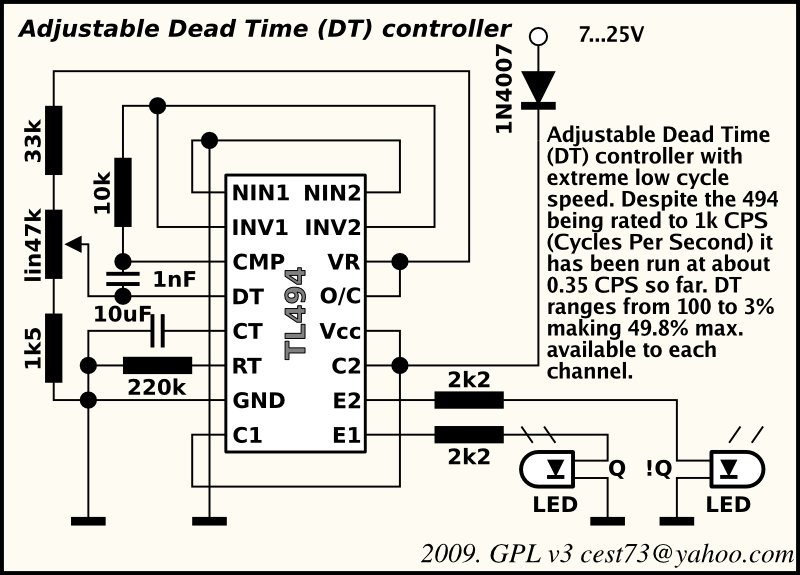

    Here i hand over my 494 schematic:
    IMHO it's all the same ballpark - just get one Q/!Q controller with dead time control.
    I did run my power stage off a 555, but to find out it needs to have dead time - for the while the two "paralleling" BJT where "Queing" the circuit just drew (150mA) without really doing anything.
    As soon as I disconnected their bases (complementary devices) and made each fired off its own opto I saw the issue is in timing too.
    Then I abandoned the 555 and searched a "Vanilla PWM". The 494 seemed to be omnipresent ATM (=was at hand ).
    As soon as i got it to "Que" two diodes right, it was childs play to have it run the "Scalar Ron Cole"
    Please don't be confused by the use of 494, it's just "a PWM with DT control" just like the SG3524 is.
    okay?
    If You like the schematic, I can expand it with the power stage section, I really would like to discuss here?

    • I also use the TL494
      Pin 6 (RT) is your frequency adjust pin and I believe the 220k should be a 25 turn trimpot.
      • Originally posted by nvisser View Post
        Yep,
        I only put it this way (fixed) not to confuse the DT too much.
        I have it SPDT switch with 470k 220k and 10K for experimenting until i figure this out...

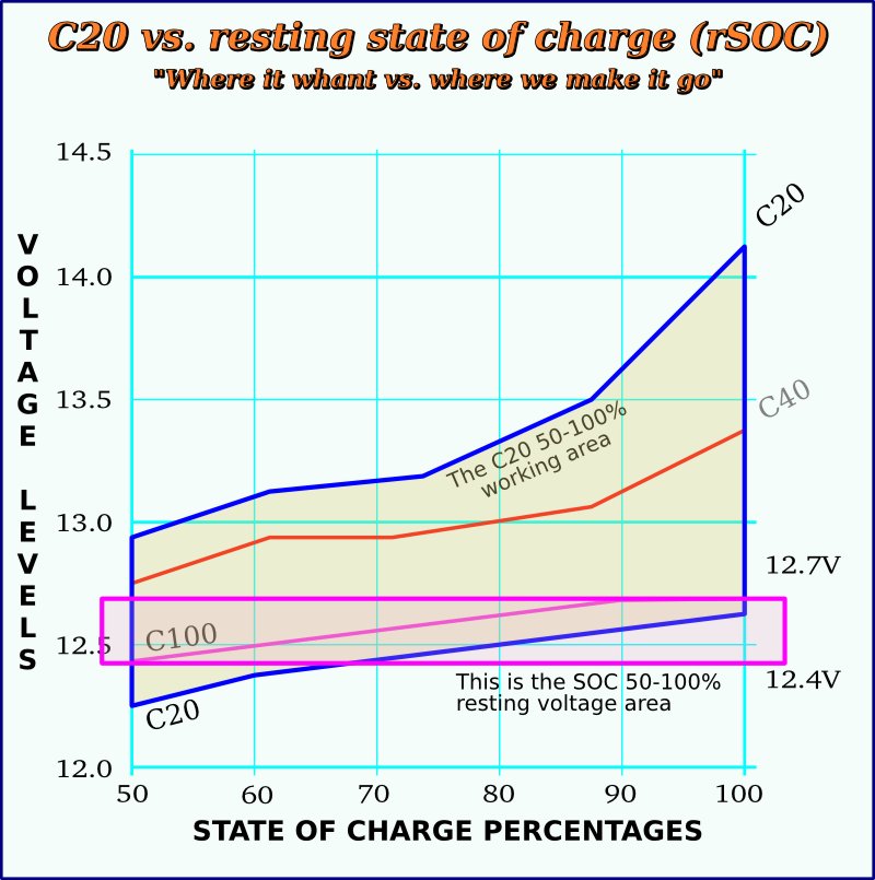

                Here a excerpt from the C20 on a L.A.B.
                Will get back with more pictures
